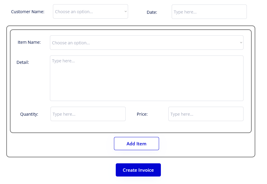

The layout for the create page looks something like this:
Each invoice can have multiple invoice items.
Currently, when the create form page is loaded, it directly creates a new invoice and invoice item record in the database. We enable auto-binding for each input field in the repeating group. However, this creates a problem where a new database record is created every time the page is loaded. How can I create and save repeating group data without using the auto-binding method and only create the database record once the user clicks the “Create Invoice” button?

Thank you for your answer. Could you please explain in detail how to save and create repeating group data without using the auto-binding method? I’m not sure how this part works.
  1. I would create each invoice item and leave the invoice field empty in the beginning, they will still be saved to the database, and
  2. add them a to a list custom state to save some work finding them later.
  3. when user clicks the button to create invoice, create a new thing (invoice) and then make changes to list of things (the custom state’s list) where invoice = result of step 1 (create invoice).
