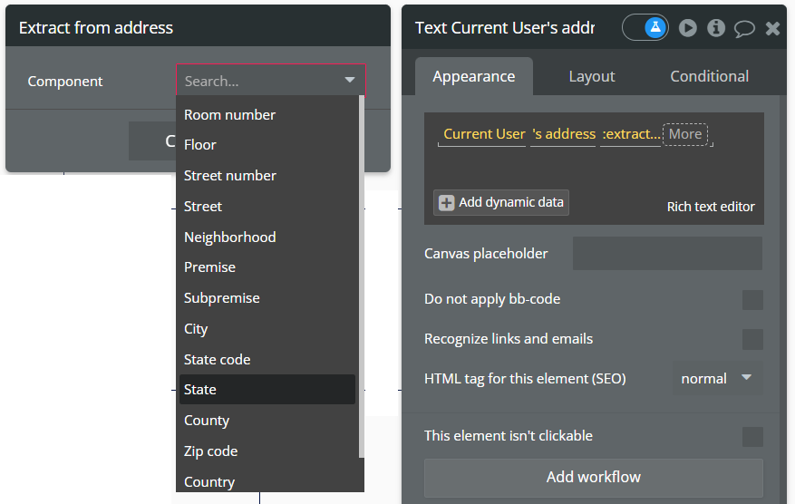

I have created a field called address with data type Geographic address.
I have added the GeoAPIs to my app.
I need to figure out how to determine is if an address entered is in California. How do do I do that from Geographic address field? What condition do I invoke?
Thanks.
Charan
Hi there, @accts… when you use the :extract operator on a geographic address field, state is one of the many components you can extract and subsequently evaluate (for example, is the state extracted from the address “California”).

You asked how to extract the state from an address… not being able to save the address to the database is entirely different, of course. Share screenshots of your setup and your workflow, and check the debugger to see if it can provide any clues. You could also consider contacting support to see if they can help.
I was not able to use the solution you suggested for extracting the state, because as I found that the workflow does not save my data (input address) to a geo address data type. Hence it cannot extract anything.
The way to extract the state from an address is what I gave you because that was the question in your post. You not being able to use that solution because you can’t save the address is, as I said, a different issue, and if you don’t want to share more details about that issue, then it won’t be possible for anyone to try to help you figure out why it’s not working.
