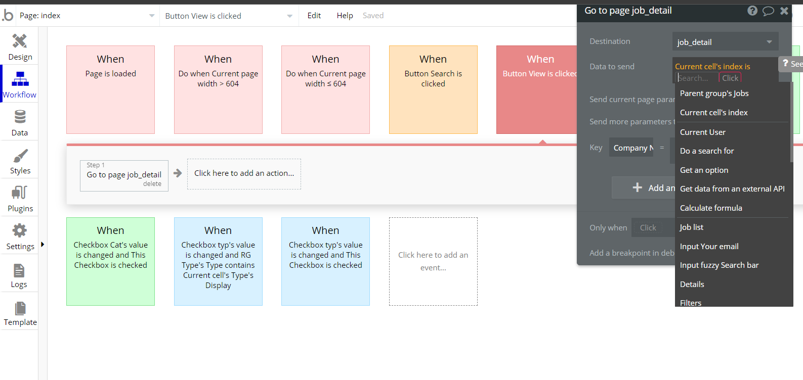

this what it shows when i start the workflow
It show current cell’s index I don;t know that I am in the right track
and I don’t know how to complete the condition
pls help me
Assuming your RG has a content type of ‘Jobs’, and the button’s parent group, which has a content type of Jobs, is inheriting the current cell’s Jobs, then just use Parent Group's Jobs as the data to send.
