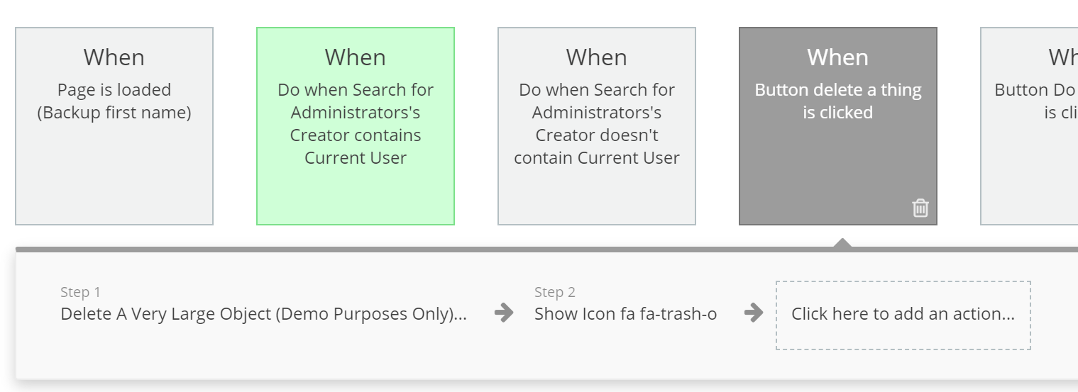

If you’re talking about operations in the page, note that Delete operations do execute synchronously. For example, the following workflow:
Causes a progress bar in the browser. Step 2 (which simply sets an icon to visible) does not start until the progress bar is done (the object is deleted). So it seems that, at least client-side, one does not need a “results of step 1” to enforce synchronicity.
[I can’t say for sure if this is true of an API Workflow / server side, but I’m guessing it is.]
