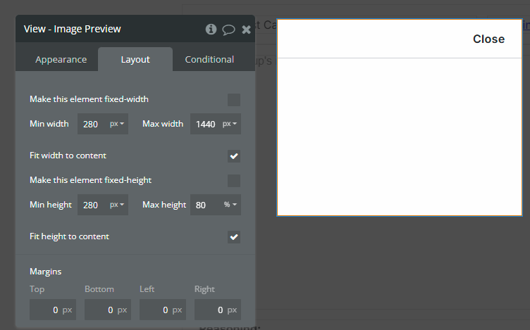

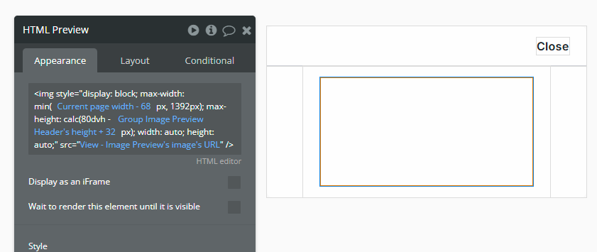

Hi @peterfwriter,
I did something similar. This is my set up, hope it helps:
Popup container (reusable)
Instead of using an image, I used an HTML element:
Whenever I use the element:
