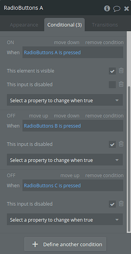

Hi Mike & Kevin,
I attempted to give the radio buttons a try and nothing is working.
I created 3 radio buttons (EG RadioButtons A-C). As can be0 seen in the attached pic. Radiobutton ‘A’ is setup. However, when I do a preview the radio buttons for B and C can also be pressed when my instructions state that they should be disabled.
I tried a lot of variations the last 3 hours so now it’s time to ask what I’m doing wrong.
Thank you,
john

The why not is because is pressed doesn’t do what you are thinking it does. You will likely need to use a custom state to know that a particular radio button is selected and then key off that state to disable the other two.
Best…
Mike
