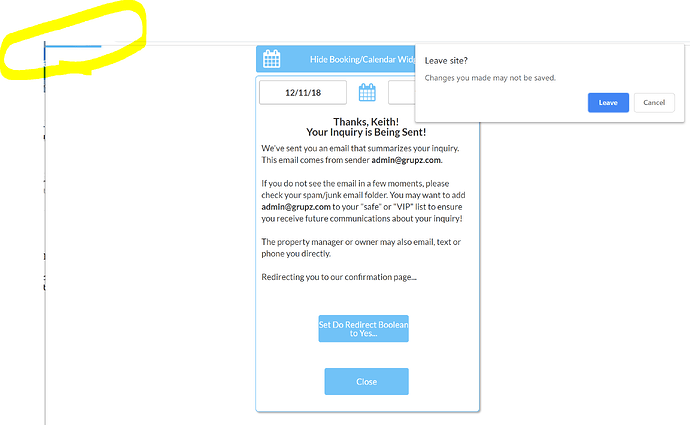

But in bubble I get this browser message alert whenever this happens, i.e. when I click on a google event from my bubble fullcalendar.
Yep! That’s exactly how this dialog is triggered and there just needs to be a way to suppress it when that behavior is undesirable.

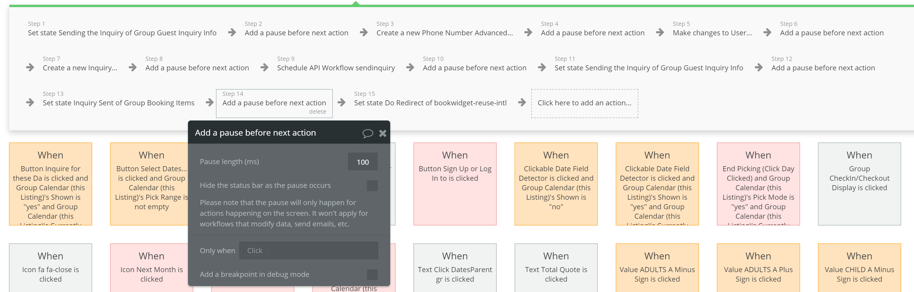

The weird thing is: I’ve tried to insert pauses all along the way to enforce a measure of synchronous behavior. Here’s the workflow where I’ve inserted short pauses between every single step (which theoretically forces Bubble to wait until each previous is complete, right?):
Here’s an example of what happens. In fact, there is a progress bar going… But how do I know when the progress bar is not displayed (and no actions are pending) so that we can safely and silently redirect? Image:
What I find is that – on my desktop system – if I set that final pause to be 2000 ms, this gives the progress bar time to complete and the redirect will in fact happen without a nag. However, this isn’t the right way to do things as the time required is dependent on a huge number of factors.

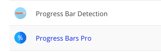

I didn’t try that one, maybe it can help? I’m in patching mode! :slight_smile:
edit: just bought. Works great.
It’s the same app and page I noted in the bug report, @neerja. The only thing I can think here that might be messing up the synchronous nature of this workflow is the Schedule API Workflow step. (Question: Do those steps return a value? I’m away from my machine at the moment, but that’s my next thing to look at.)
According to the plugin, it sounds to have a returned value.
events:
edit : just realized they have two products:

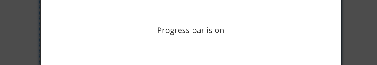

Here’s the page at that moment:
As you can see, we’ve already gotten to the point where the JavaScript redirect is triggered (by a Custom Event that I’ve not shown above). The blue progress bar (though it will not take long to complete) must represent our friend Step 9.
