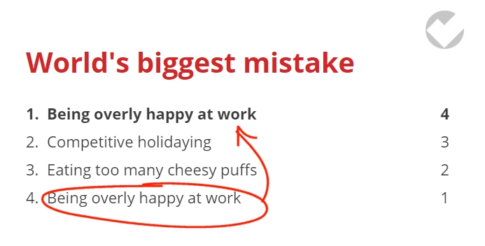

My app asks users questions, such as, “What’s the world’s biggest mistake?”.
All submitted answers appear in a leaderboard of answers - however, when a user gives an answer that’s already been submitted, I can’t work out how to aggregate that answer with the existing duplicate answer (simply by increasing the existing answer’s “vote” count by one)?
Currently, duplicate answers are being listed in ADDITION to the existing entry - see image.

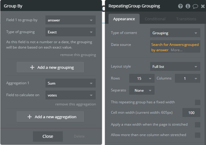

There is a :group by function. Group by the the answers, using the sum of votes as the aggregate.

on the repeating group. It should be Search for Answers: grouped by (Answer, aggregate by sum of votes)

Thanks again Alan. I’ve given it another go but not working - can you tell from the inspector where I’ve gone wrong? Cheers

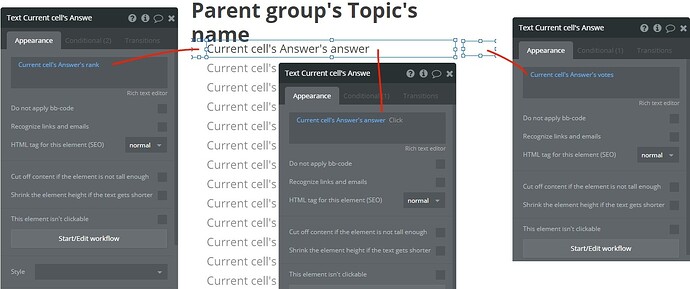

In the Rep Group, have a text to display the answer, then a text to display Current cell’s Answer’s Vote’s :sum (or count, depending on what works best for your data)

But inspector doesn’t give “count” as an option in rep group cell for vote count…

To clarify each cell in your repeating group should have a text with the Answer displayed, then a separate text with the Votes sum.

The data type is an “answer” so I’ve got as text. As I say, the inspector doesn’t offer “sum” as an option, in either the “rank” or “votes” cells.
