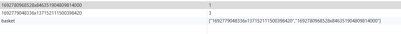

I am trying to create a shopping cart using LocalStorage (LS). I couldn’t find any threads related to it. I thought it should be more efficient than creating extra datasets. Everything was going fine: when I click on the button, some fields in LS are created, and then I retrieve them in the header (a reusable element) to list the products. I created a private plugin that returns the product quantity in each row of a Repeating group, which helped me to change the quantity in the shopping cart

But the problem arises when I try to delete a product from the shopping cart. You can take a look at the example below: the remaining element inherits the quantity of the deleted element.
GIF 18.10.2023 11-46-32
I understand the reason: after deleting, the element remains in the HTML but its style.display is set to none , and the product quantity value obtained from my plugin is still present.
Clearing the Repeating group and resetting the parent group can’t help. I see that the only solution is to ‘refresh’ the HTML or remove this row from the HTML. However, everything I’ve tried so far hasn’t been successful. Does anyone have any ideas on how to resolve this? It’s frustrating to realize that this approach to creating a shopping cart isn’t working :sob:
