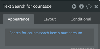

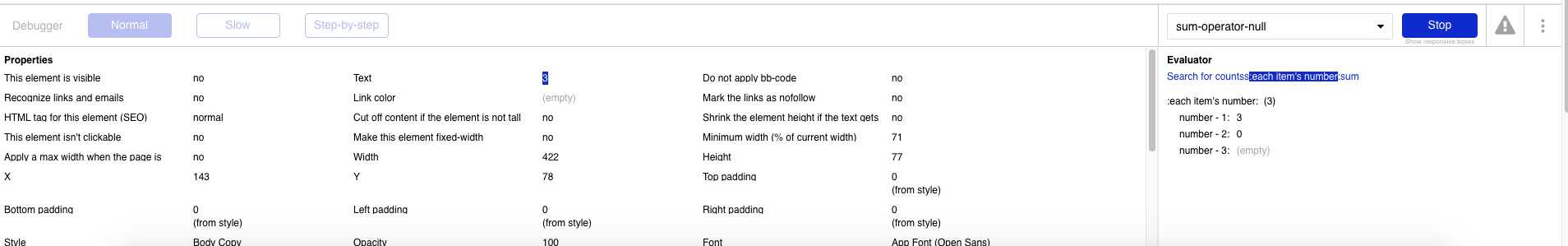

all the math expressions result in 0 not null so you just have to use the sum or count
although annoyingly this is different for field data…
field + field = null instead of 0 if any is null
to get around this you have to set the default on the field in the table to 0
then if empty it will be 0 and therefore
field + field = 0 instead of null

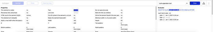

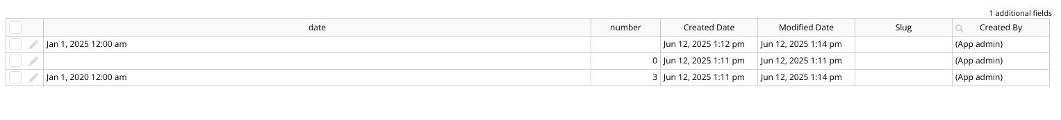

similar bubble peculiarities also apply to dates where null dates aren’t treated as null but as jan 1 1970 - this can cause real whackiness for "get min date etc) if you don’t also apply date isn’t empty
one of those bubble gotchas that you only learn after hitting your head against the wall for a while trying to debug something that should work but doesn’t
you might have hit a bug on that, as it shouldn’t and in my testing doesn’t do that
This also might have been a bug, as it works as expected in my testing
maybe they actually fixed the bugs I reported months ago…
I never received a response once it was passed to the engineering team so I gave up on it
good to know the issue is now resolved

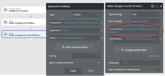

Thanks for the input. To add some context, here’s what I am trying to achieve:

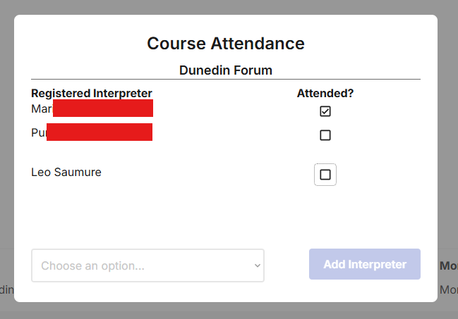

The interpreters listed in the screenshot below have all registerred for a PD session. All the data about that session is listed in the interpeter’s ProfDev table, including points, date, duration, etc. When the administrator clicks the attendance checkbox, the first portion of the workflow changes their attendance in the ProfDev table to yes. All well and good.
The second portion of the workflow is meant to update two fields on the user’s table: Current Point & Last PD Date. This gives an up-to-date and at-a-glance record of the interpeter’s current PD status.
The Current Point field is set to number with a default value of 0
The points are adjusted properly when the search criteria yields results. However, if the search criteria (as in this case) yeilds an empty set or null results, the field is adjusted as a null value rather than a zero.
Note: The Last PD Date change is working as needed as it uses a different search criteria.
What I’m thinking I might need to do, is adjust this step of the workflow to run only when the search criteria delivers an actual result. And add another step in the workflow that will change the value to zero if the search criteria count is less than 1.
Thoughts?
