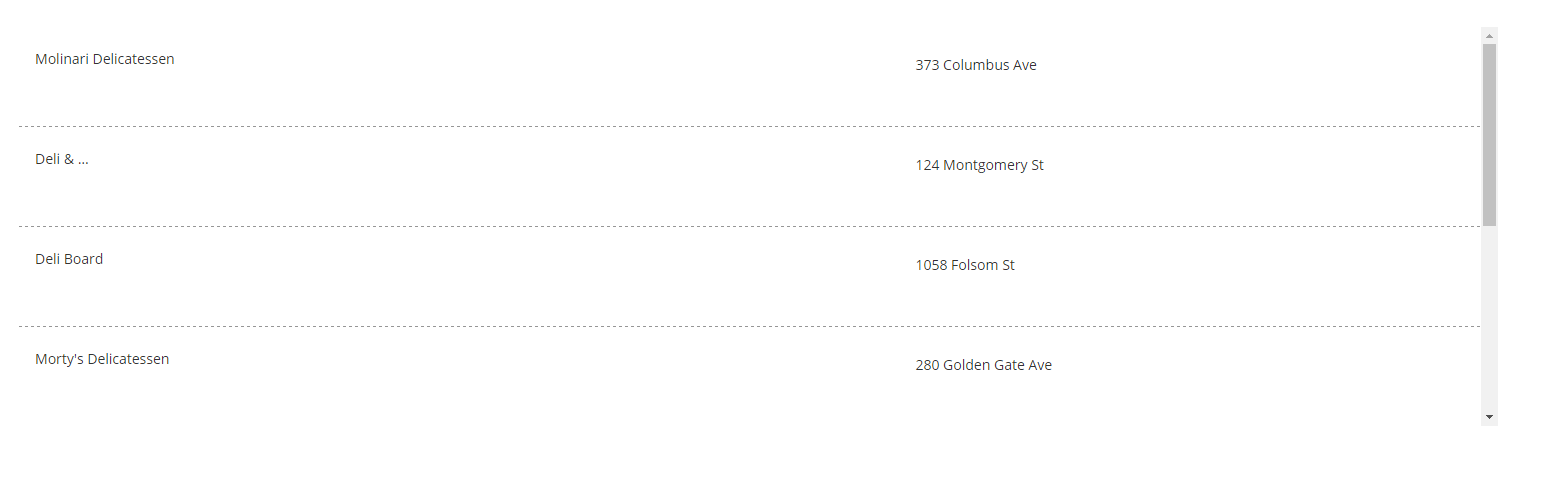

I set the “Main List” to be Businesses…
…added some text to the repeating group … and …
Is that not what you wanted ?
Wow!
I get it now, that dropdown allows you to choose what data you need, businesses or open hours of businesses.
Great job @NigelG Thanks!
Yes, if there is an array in the results, you can bring that back as a list for Bubble.
You seemed that have got almost all the way there, so wanted to check if that is what you were after :slight_smile: :slight_smile:
