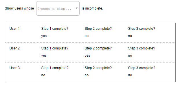

Hi there, @gaixin.hong… if I understand the concept you are describing, it might look something like this…
incomplete1
… and if the user selects Step 2 from the dropdown, only Users 1 and 3 would be shown…
incomplete2
Is that the idea?
Best…
Mike
Thanks so much for your applying. Yes, that is quite the way I am doing. What is the implementation of doing that? You do a search of the User or give several conditions? If you give several conditions, what if we have like 10 steps? Thank you again.
There are a number of ways to implement this concept, but I like the idea of having a list of incomplete steps (i.e., a list of texts) at the user level. So, a user’s incomplete steps list starts with all of the steps because they are all incomplete. Then, when a step is completed, you remove the step from the user’s incomplete steps list via an action in the same workflow where the step is completed. Finally, the repeating group is set up as a search for users with a constraint where the user’s incomplete steps list contains the step that is selected from the Choose a step… dropdown.
