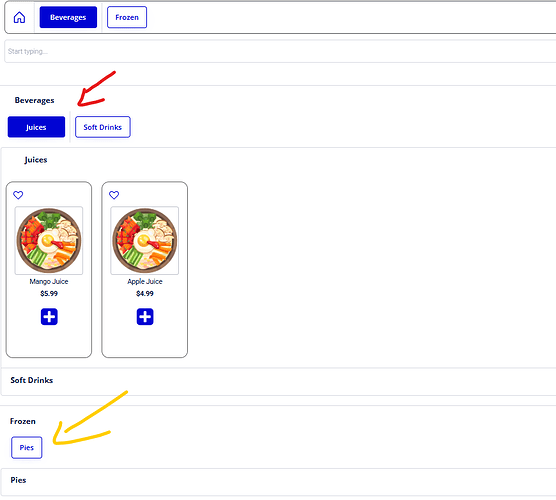

Below you can you an image of what I’d like to do.
As pointed with the red arrow, I’d like to do the same with the subcategory “Pies” pointed out with the yellow arrow.

Hey, thanks for replying. It helped a little, this info is exactly what I want, but I couldn’t apply the same logic to get that on a Custom State. Not sure if there is a way to do that or I’m missing something in the way.
Have you faced anything similar?
( To be clearer, I’d like to have a list of all first subcategories of all categories. They will be visible as soon as the page is loaded. The information given in the repeating group is exactly what I want, but I couldn’t put it in a custom state )
Thanks again for you time.
