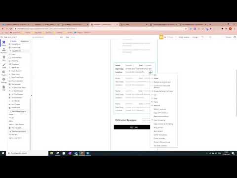

Hi,
Can you let me know if you can see the video at the end of this URL. I have attempted to record my screen as i do not think i would be clear enough typing it out!
https://bluejeans.com/playback/s/uj5gDnCw0UVGWHRLLxNjp5yoYQgjbiEX2IugiLE6d2KtIwAgoq1V4LnNgKTq3mCa
It brings me to a sign in page
Booo :slight_smile:
I have no idea how everyone is recording their screen but I have had to upload to youtube.
If you still have time could you have a look and let me know if you have any ideas:
Create a custom state called selected items or whatever the things are that they are selecting using the checkbox. When they check a box add that ‘current cells index’ to the custom state selected items. The custom state will have a data type of number and be a list as the current cells index is just a number.
You are creating a list of numbers representing the selected item number from the repeating group.
Then in the workflow you have successfully running that goes through each of the repeating groups items you can set a conditional to add only the repeating groups items whose index is in the custom state selected items.
