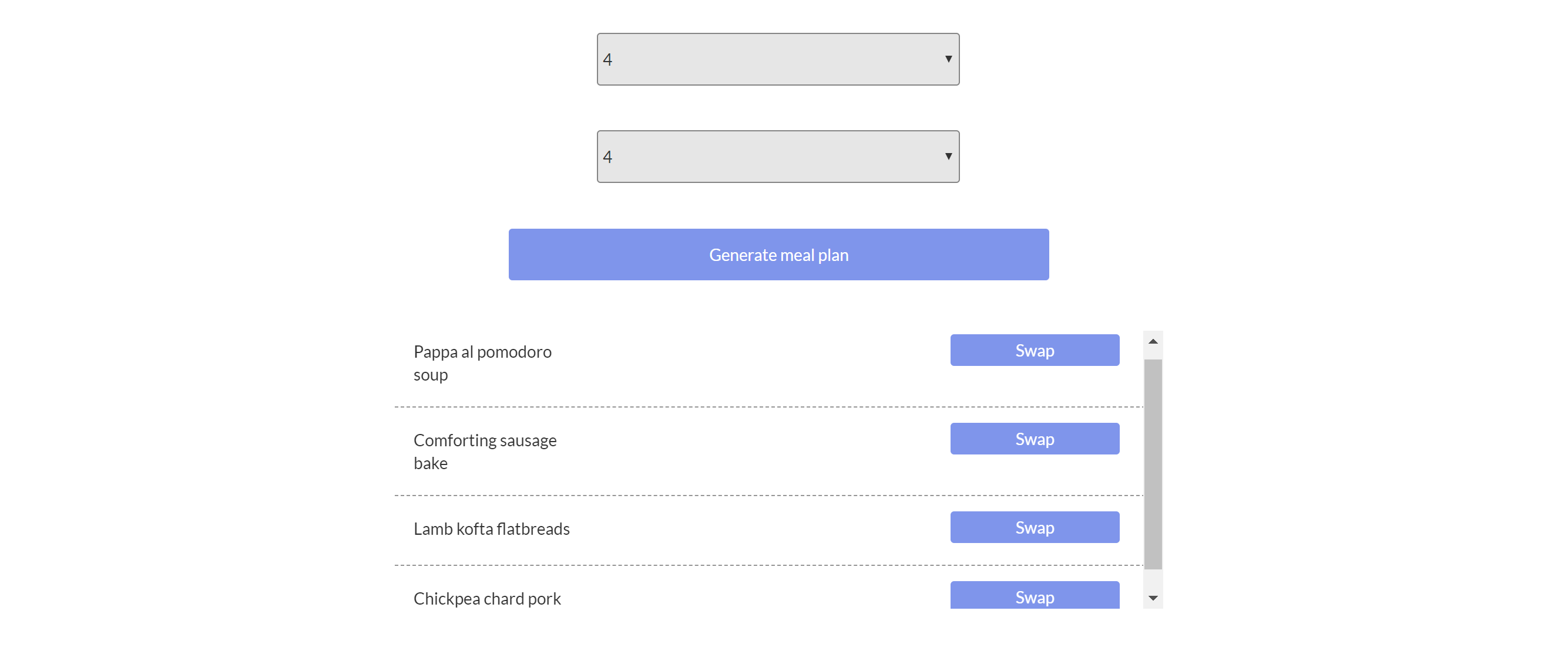

I’m trying to create a simple meal planning app. and need help figuring out how to update a list of recipes (i.e. the meal plan) on a subsequent button click.
What I’d like it to do is…
A) allow a user to input requirements (number of meals, number of portions per meal), B) generate a new meal plan (i.e. a list of recipes), C) change one or more of the recipes based on a button click, D) save the meal plan, email to the user, E) add the ingredients to shopping basket.
Parts A and B are working fine. I’m struggling with part C. (Haven’t started D or E yet).
Here’s what I’ve tried…

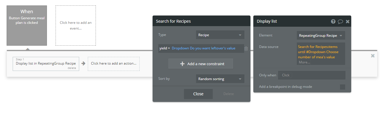

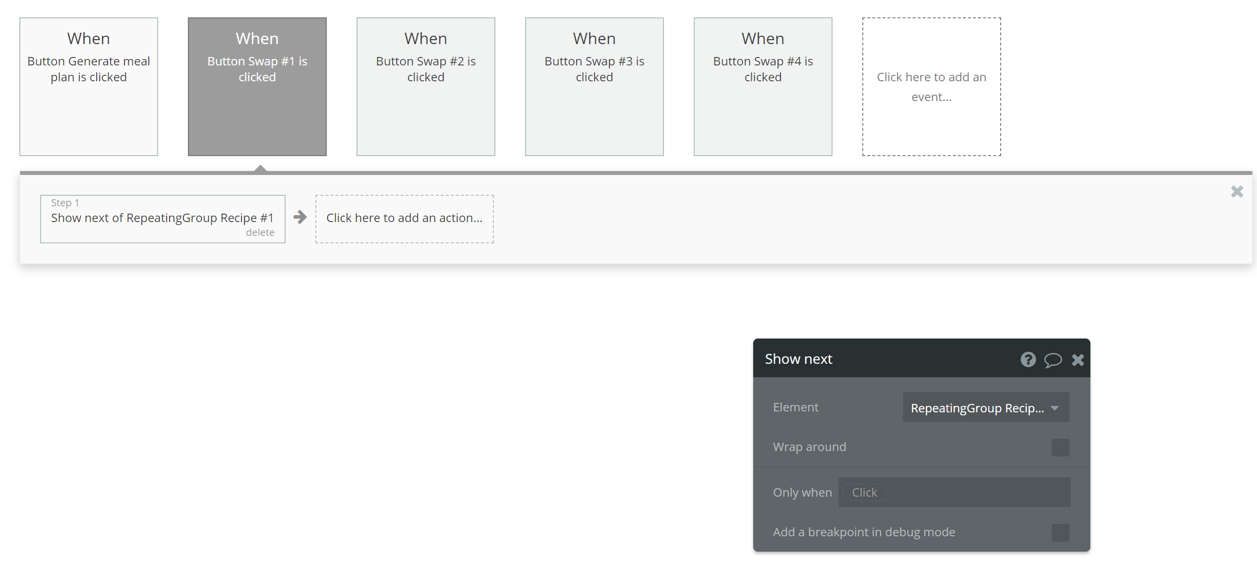

Failed attempt #1) Hit button Generate meal plan. Search for recipes where the yield = ‘number of portions’ per meal. Display number of recipes = ‘number of meals’ in RepeatingGroup Recipe (this bit works OK). Hit button Swap. Show next of RepeatingGroup Recipe (this bit doesn’t work).
(I guess attempt 1 failed because the list of recipes in the repeating group is equal to the ‘number of meals’ hence there isn’t a ‘next’ recipe to show.)

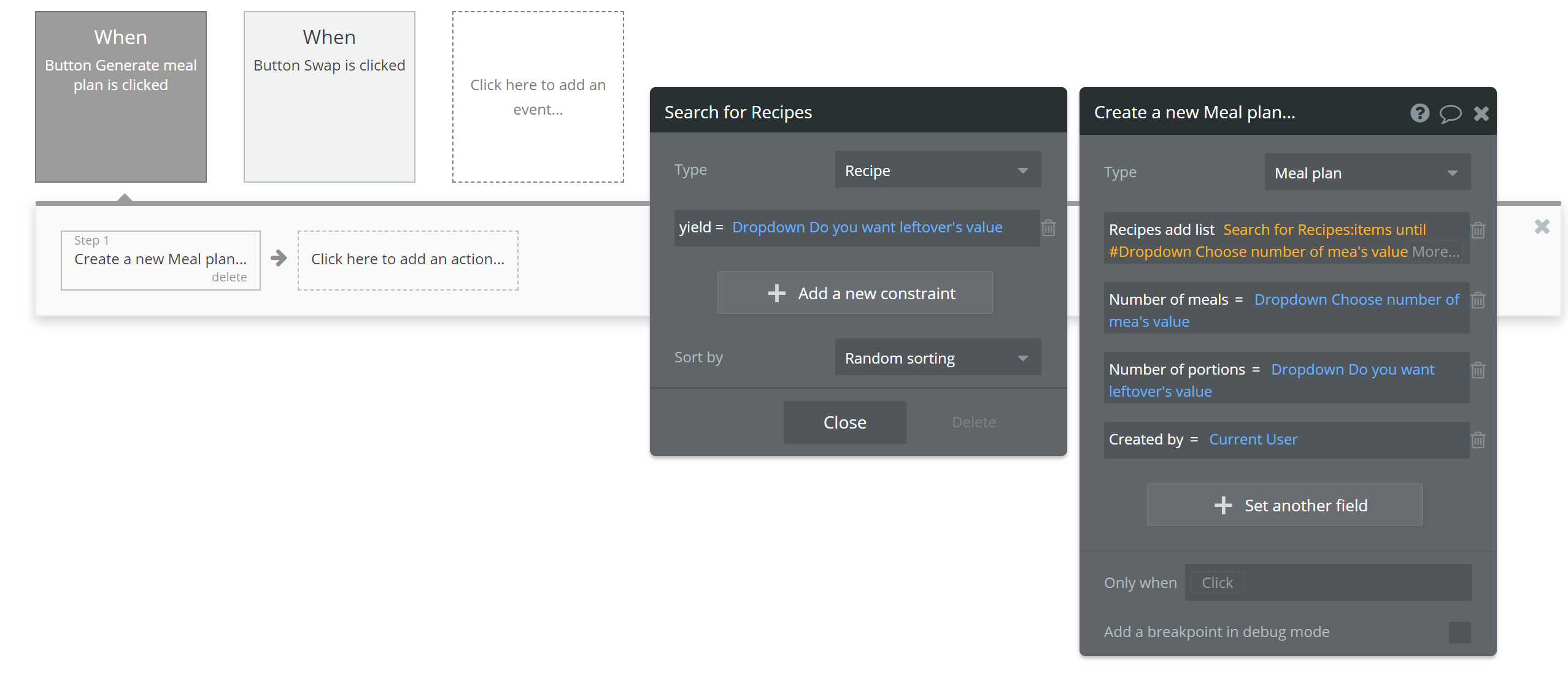

Failed attempt 2) Hit button Generate meal plan. Create a new thing (Meal plan). Add fields to Meal Plan: list of recipes (using same search as above), number of meals = input value, number of portions = input value, created by = current user. Display list in RepeatingGroup Meal plan, data source = Results of step 1, Display number of recipes = ‘number of meals’. Hit button Swap. Make changes to a list of things (Recipes). And pretty much get stuck here (I’ve tried a lot of workflow options)…

If so, the “Display list” function is working correctly. (Every time it searches, it’s going to look at the list the same way, unless you tell it to be be sorted randomly). You can use the :random sorting" function to make it so.

Hi Dan. Yes, you’re correct, I’d like to display a different list of recipes each time.
I’m using the Random sorting function already, however, the list of results appears to be the same each time during a particular session. I.e. The results differ session-to-session but are the same within sessions, if that makes sense.

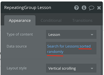

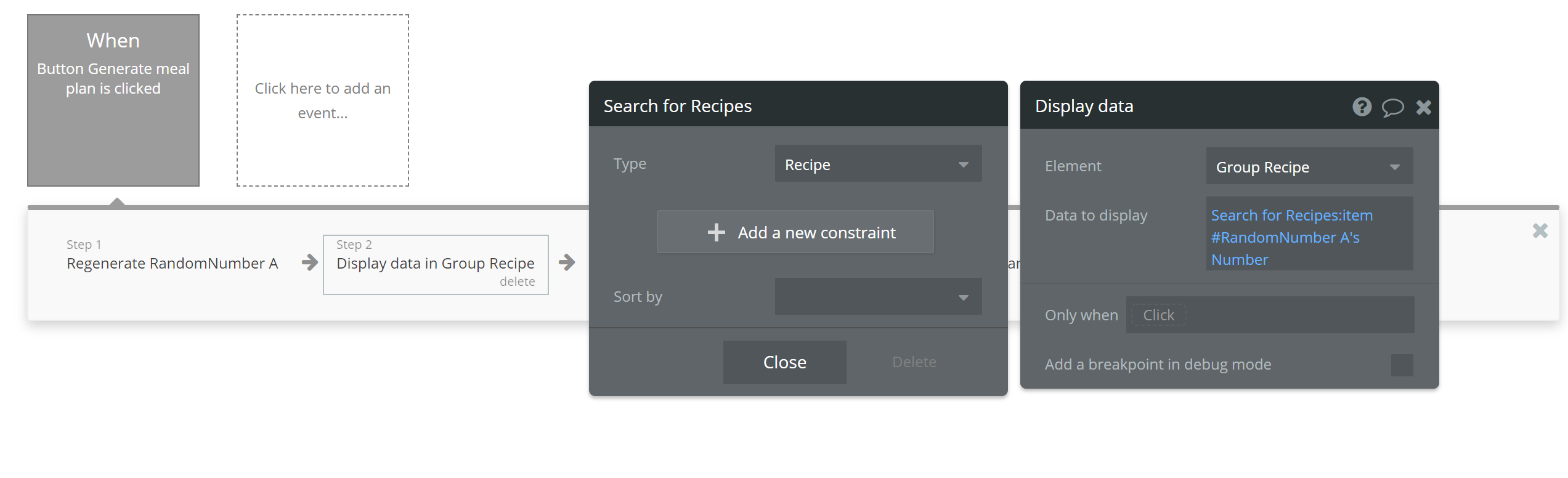

As for the random sorting aspect, I’ve heard that it doesn’t always function randomly (especially when the search is the exact same). Try moving the sorting action from the search itself to after the search (screenshot below). Based on a quick test, that seemed to do it in a similar scenario in one of my apps.

Are there any other conditions or logic applied to your RepeatingGroup Lesson that might be relevant?

I tried this but then ran into the issue of not being able to swap individual rows (recipes) in the RG, as desired. The entire list of recipes that’s visible (in this case, four recipes) is changed.

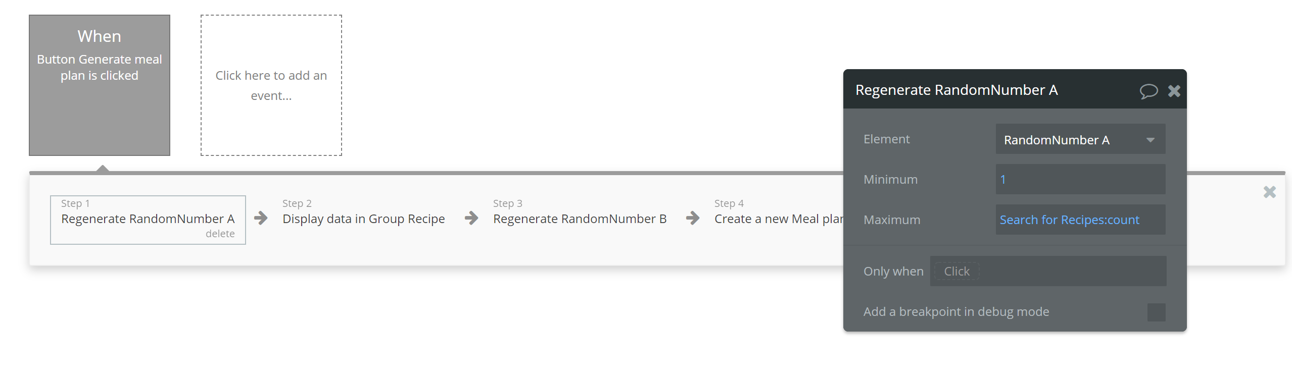

What I’ve done is use the Random Number Generator plugin. On the ‘Generate meal plan’ button click, a random number is generated between 1 and the total number of recipes in the DB. Then, it finds the recipe in the list that’s number X (equal to the random number) and displays this.
I’ve then implemented individual groups rather than a RG, as the max number of rows will be 7, and added a Swap button, which basically re-runs the workflow to show the next random recipe.
Maybe not the most efficient way to do it but gives the desired UX, which will do for now!
