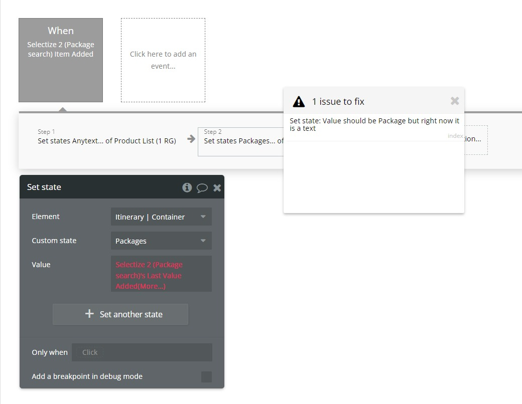

I’ve also tried to set custom state however the system prompts the multidropdown defined as “Text” so I can’t set it as Packages…

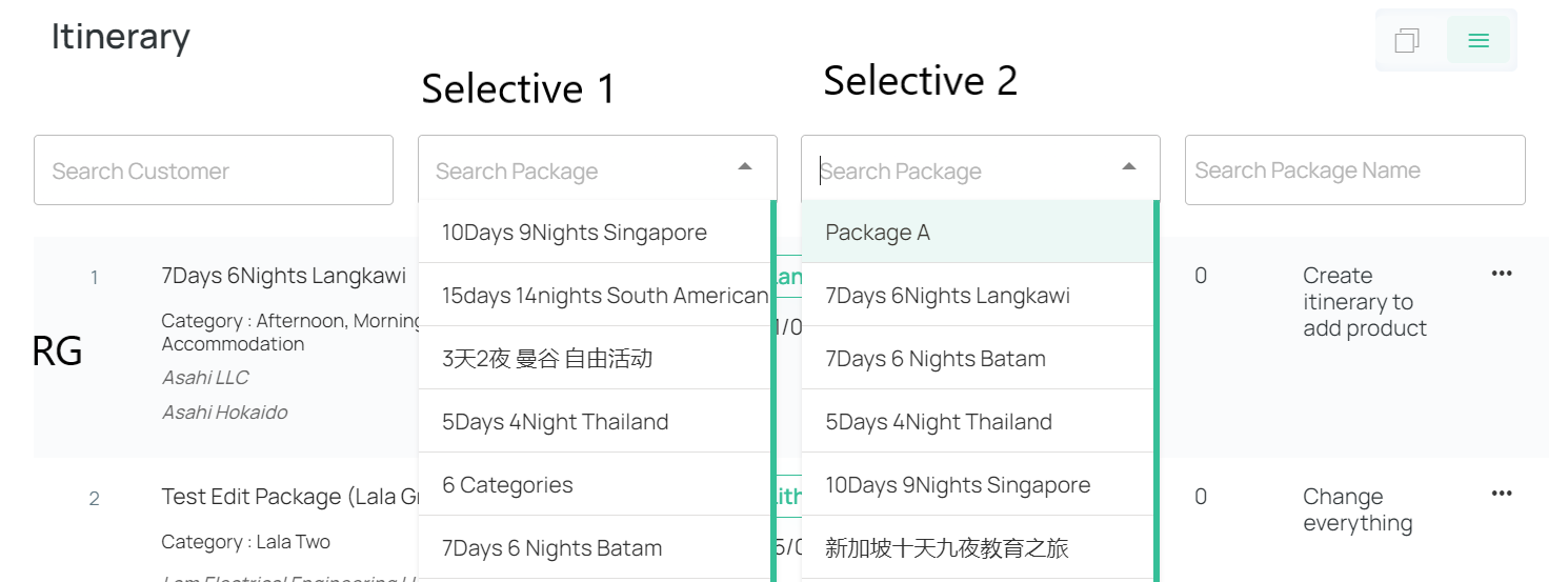

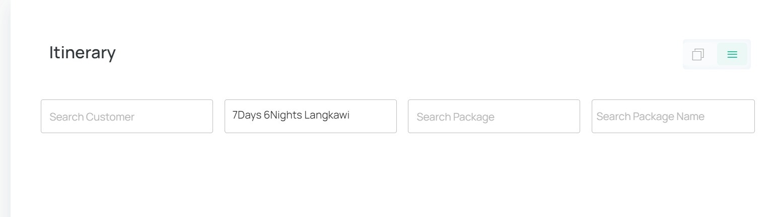

This is the screenshot of the dropdown using Selectize which displayed nicely according to what I want (to overcome Bubble default dropdown limitation in terms of colour upon hover and needing to have search dropdown box)

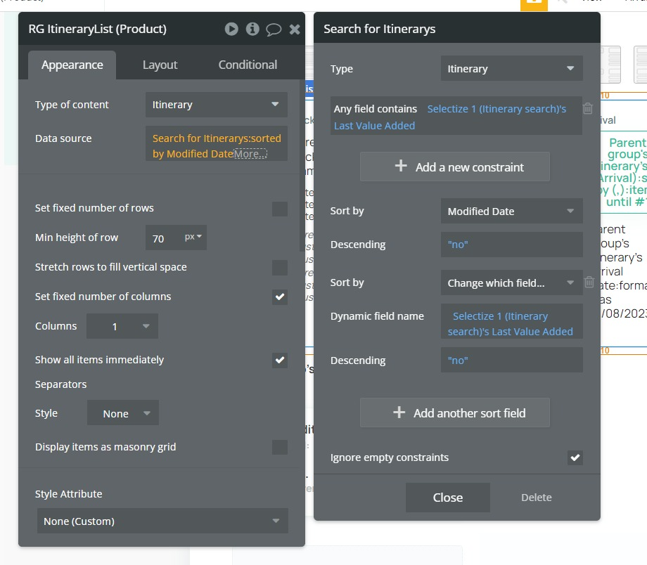

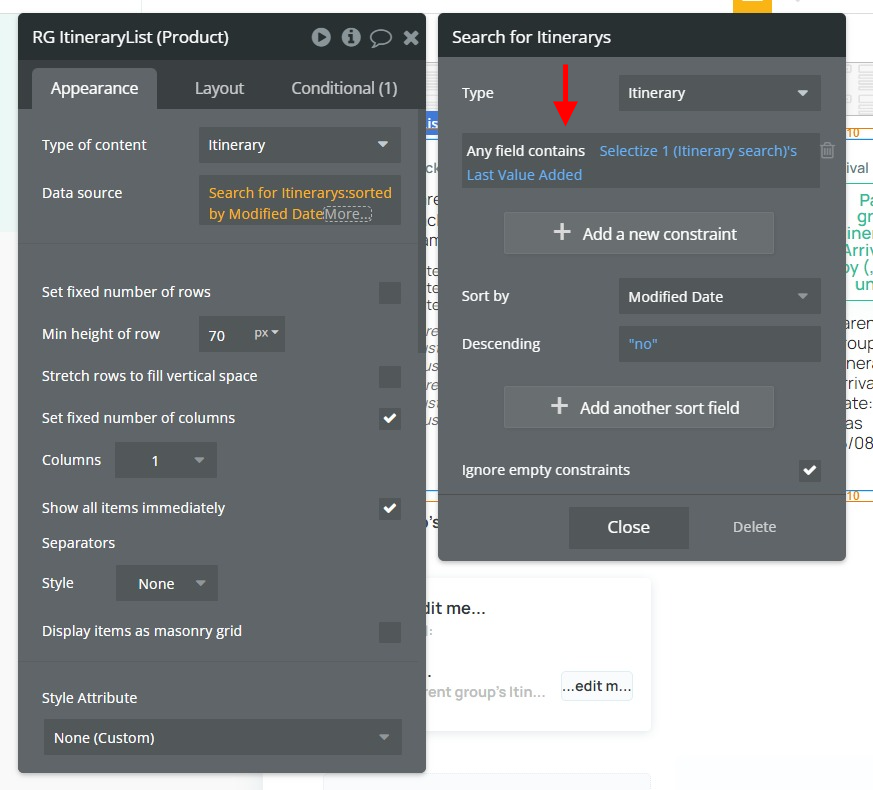

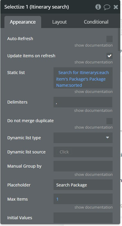

For the first drop down Selective 1, I set as follow;

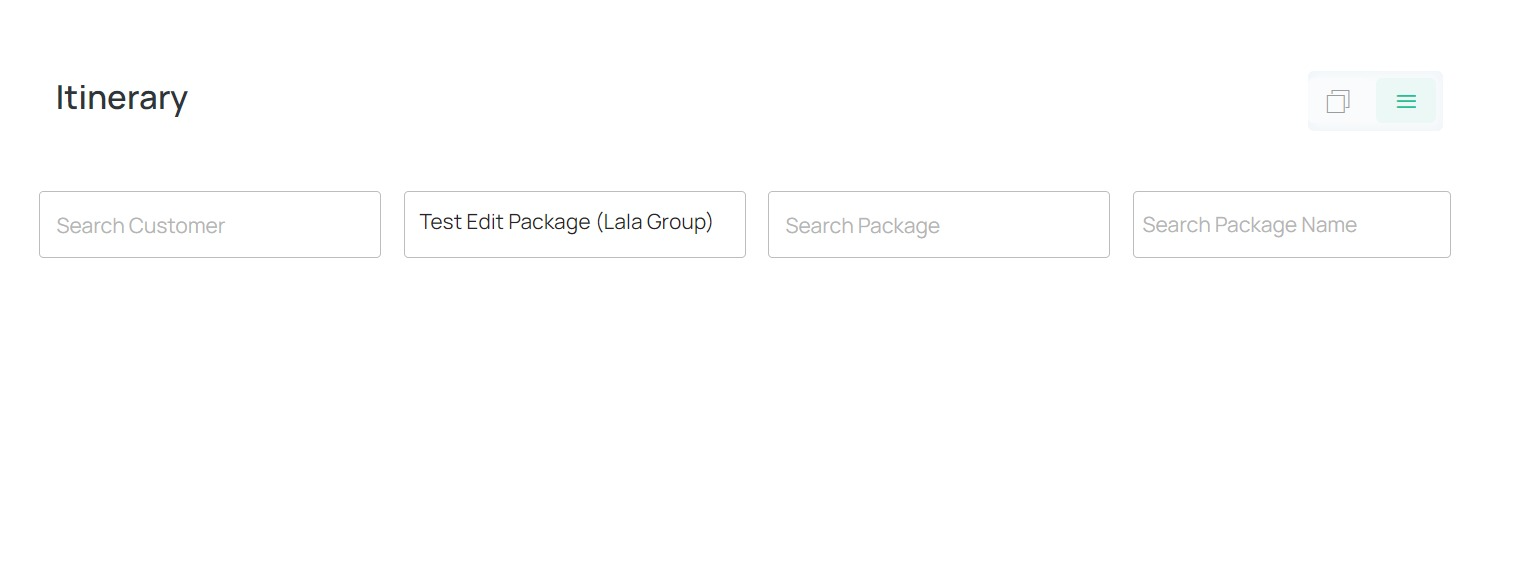

When I do a search and last value added, the RG return with empty result.
I added constraint under the search, but same thing no result after search.
RG also empty

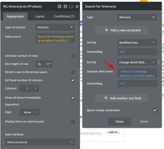

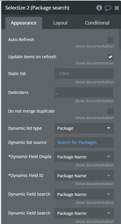

My second dropdown settings as follow;
When I do a search and last value added, the RG is not sorting at all.
I tried inputting constraint similar to Selectize 1
Then the result also empty.
I tried working on Custom State (Selective 2) but system prompted this is text.

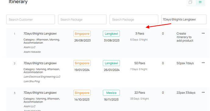

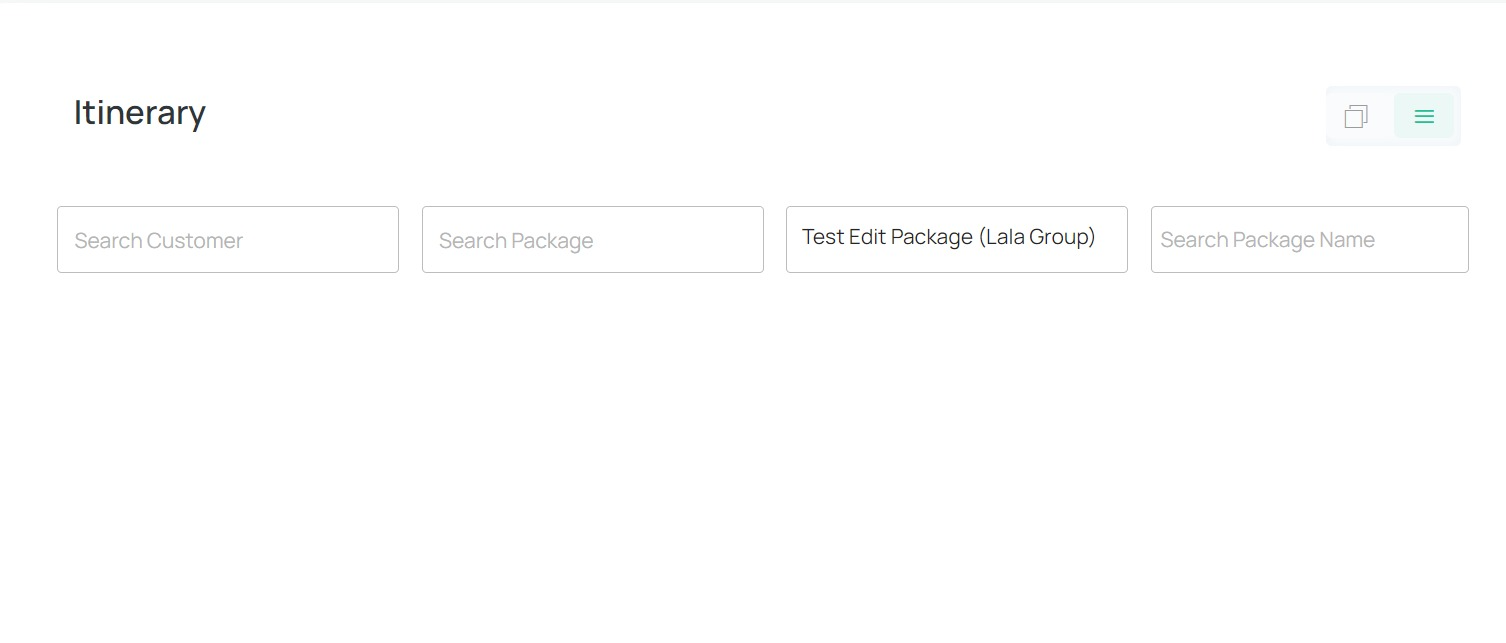

To show the RG and search is working, I put searchbox along the Multidropdown and it’s showing desired result.

What is your setting for Selectize dropdown?
This is for Selectize 2
This is for Selectize 1
Thank you in advance @Jici

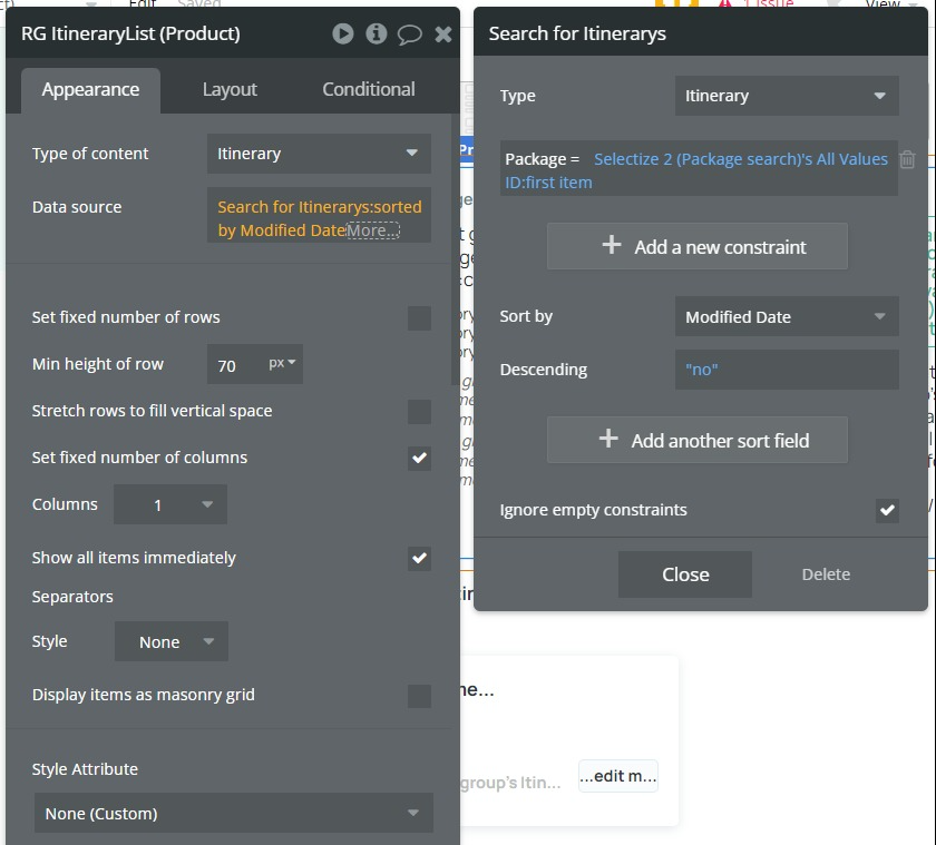

Dynamic Field ID should be set to Unique ID.
In RG, I guess you have a field Package?
If yes, your search should be package = selectize all values ID:first item (if you use it as single choice)
You don’t need to set search field because the display and unique ID are already searchable. Set other field to dynamic field search 1 to 4
Thank you so much @Jici !!
You really saved my day! It works!!

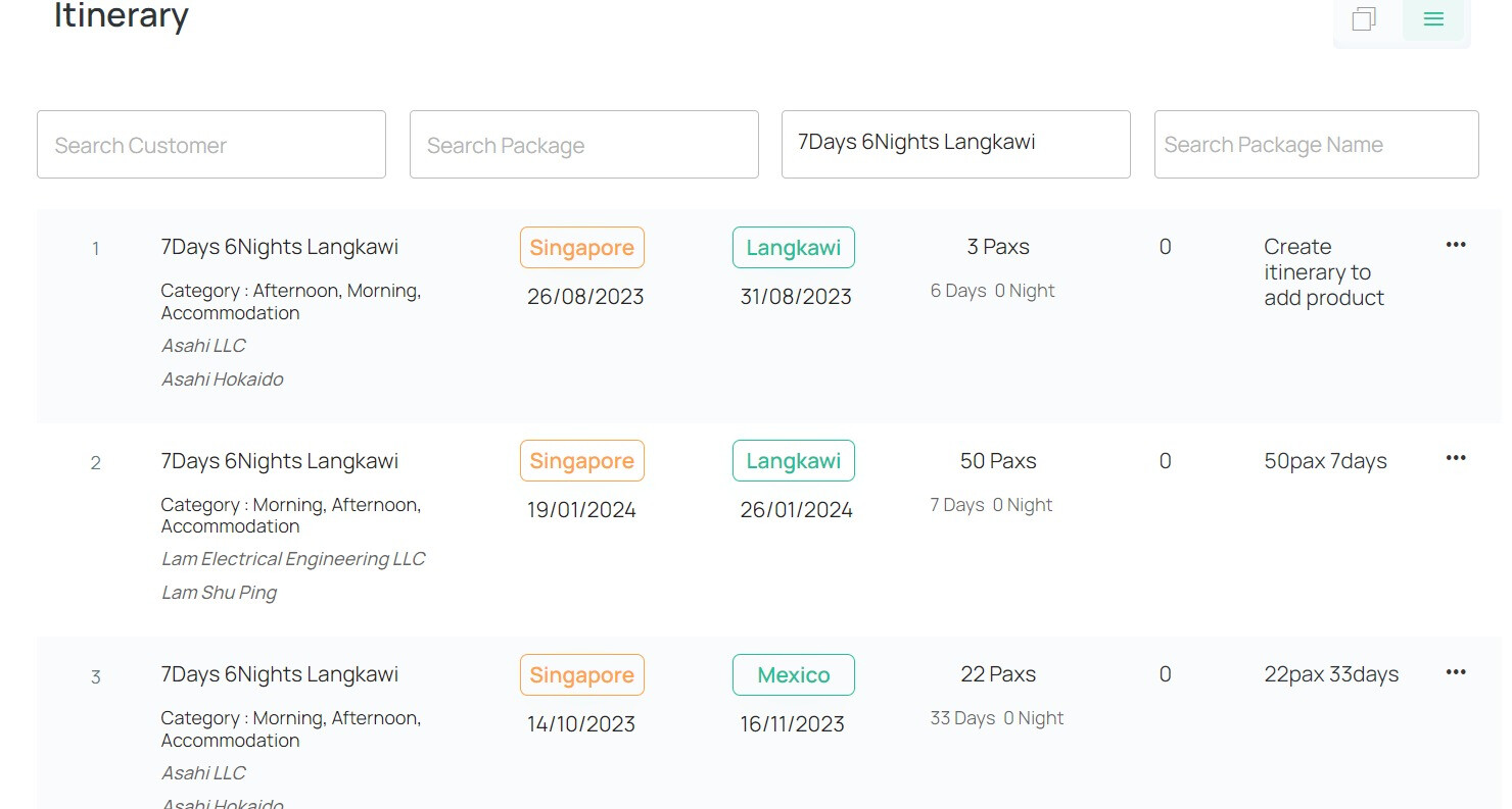

I shall include the screenshot here, just in case anyone having the same encounter like me…
Changed the Search RG
It works now :heart_eyes:
