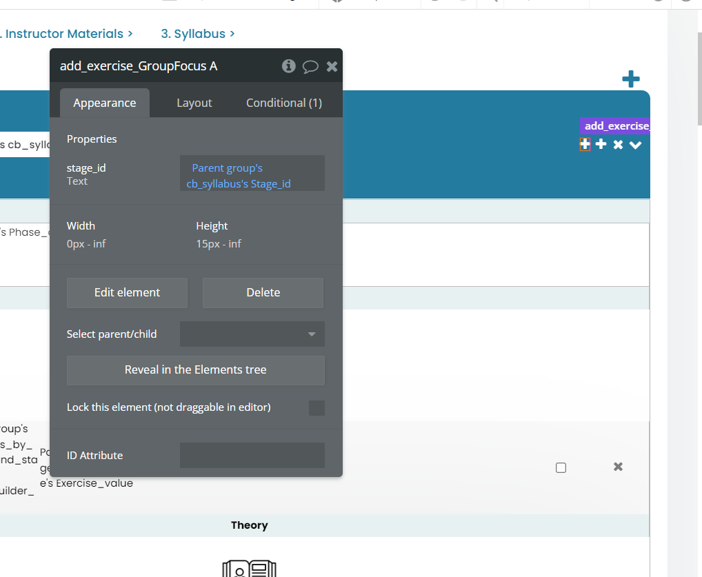

Create a reusable element. In that reusable element add the group focus and the necessary reference elements (these are usually an icon like for a menu).
Then put the reusable into the repeating group cell.

I want to pass some data to custom states of RE from the RG is this possible?
Yes it’s possible… are you having trouble doing it?
Yes I have dynamic values inside the Repeating Group Rows and want to set the dynamic state of the reusable element as you know we can run the workflows for the RE inside the RG how I will initialize the custom states then?
Use the new Properties feature for REs instead of custom states.
I added a new property now I want to set this property from RG where I added RE
got it thanks
