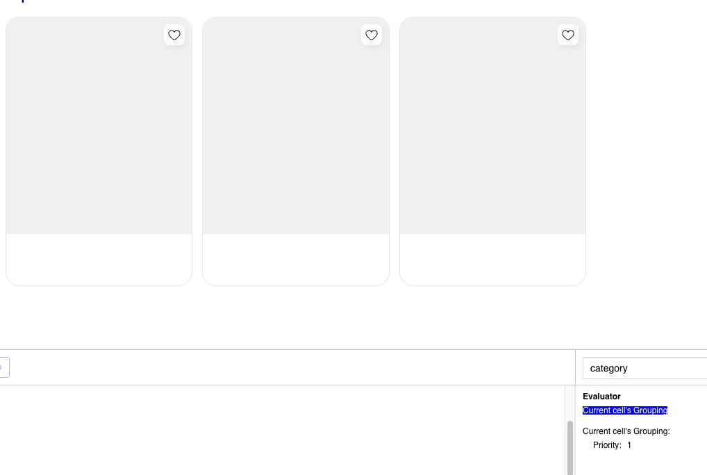

Thank you for your response. I’m not really sure how to use the grouped by operator but when using the priority field to group, the result was just three items that were all blank, which after inspecting it, each of the three is the combination of all items that have the same priority level, instead of having all the items be organized by the priority and then randomized as intended (seen in the ss).

I think what @boston85719 mean is to use two nested RG. One that will be “priority” type (if exist… if not, could be text or grouping). If you have a type or an OS for the priority value, you should use that. if not, you can use groub by. And inside this RG, add another one that will search for items where the priority = current cell priority. You will be able to use random operator for this nested RG.
There is no way around it if you also want to randomly sort them within their priority level. Remove the need to sort randomly within priority level and you can get them in order of priority without consuming extra WUs.
