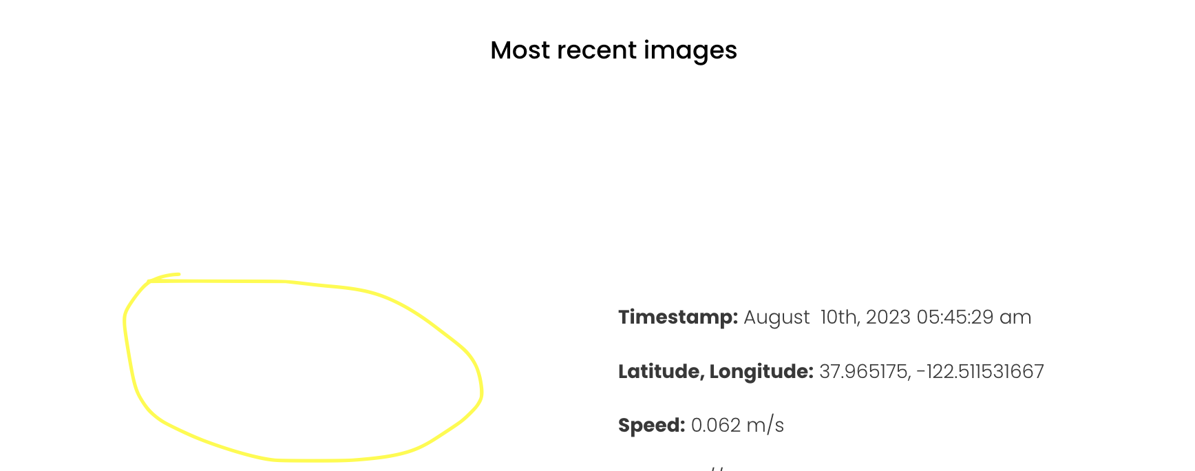

I have a repeating group that is pulling data and images from the mysql plugin. Sometimes I get a general warning in the preview debugger which says “The image could not be loaded”. The reason is because the URL doesn’t have an image associated with it yet. I’m wondering if I can collapse or hide the row when this is the case so it doesn’t look so horrible to see a bunch of rows with empty images.

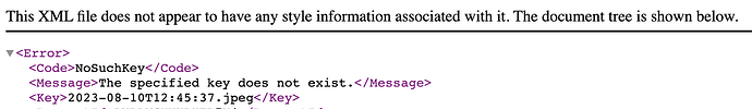

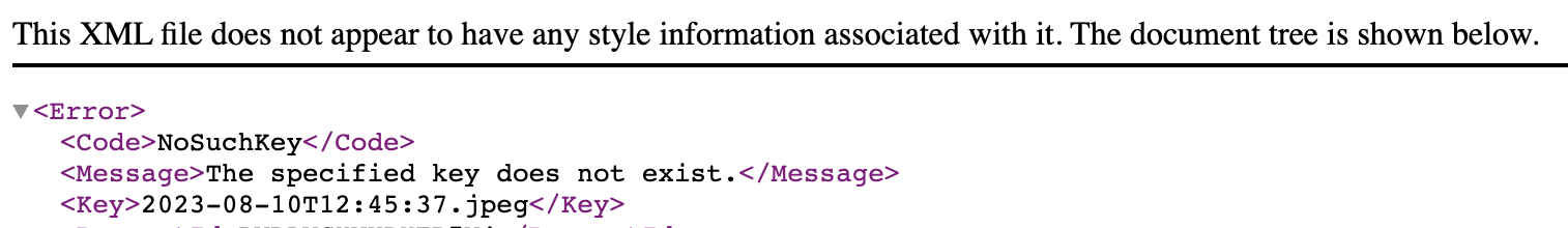

Hey @GH5T - thanks for the super speedy reply! The image field is not empty. It has a URL but the URL doesn’t yet point to an actual image so if I were to try to open it in a web browser I would get a browser notification that there’s no style information. Basically I haven’t uploaded the image yet.
I’m not technical enough to know how Bubble knows that the image could not be loaded. I wonder if I can somehow get the information and then use a conditional? :thinking:
