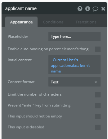

application4
Finally, on the application form that the user fills out, you can prepopulate the fields by filling out their Initial content as follows…
application5
