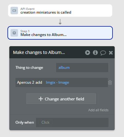

I tried using front end worklow, and programming backend API workflow, but same thing happens. Here is how its saved :

You problably have a race issue where too many backend WF trigger at the same time (or almost).
I’m not sure exactly how you have set your process. Can you share the whole process steps ?

I use this action. I tried with backend and frontend worflows for same results.

Just found a way to fix this.
At the very end of the upload, (lets say when 50 photos are all uploaded), I schedule worflow on a list, the list being : List of files uploaded filtered : this file name is not in thumbnails list: each items file name. I add 1 sec delay to avoid the “race issue”.
This way I can schedule the API on a list of 5 to 10 files max and reduce wait from users. This completely avoids having missing thumbnails. I added a custom state for the page “importing pictures” that gets changed when all thumbails have been generated to avoid user running actions such as saving album before it being all generated.
