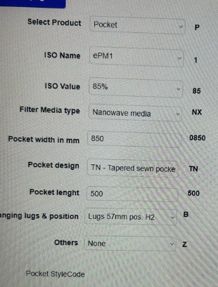

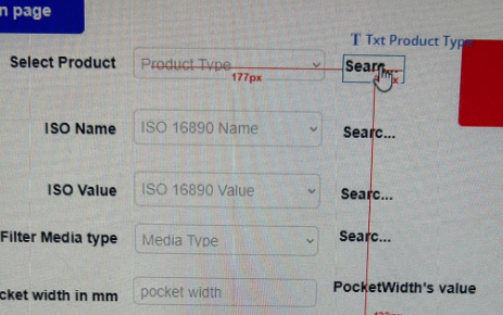

Hi, I have situation where I have several Drop-downs with choices and each choice would have a different code which will be displayed separately. Now I need to make one common field where all those code values are joined together in one long code. I created separate text field for this long code and expected to add “Dynamic data” and select just “Txt Product Type value” etc… the Dynamic data entry doesn’t allow me to to have an option ‘value’. It allows to operate with ‘height’ and ‘width’ which I believe refer to field size. Belwo are pictures from Designer view, Dynamic data field & UserView… What I try to achieve is one long code like P185NX… etc…
Please give me some hints…
User view
Designer view

I did solve this myself and figured out solution. I fetched these special individual codes from Data Type where the dropdown selections are with corresponding coding values. So instead of taking this data from visual text field, I took it from data base. I also needed to add Constraint in a Search for. So it looks like this in end and works :slight_smile:
