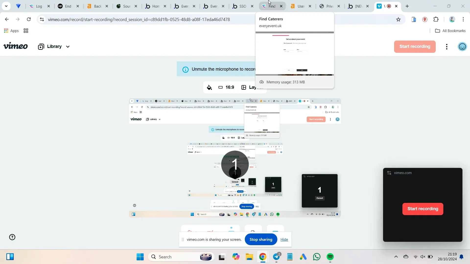

When I animate one element out, then another element in, a scrollbar appears at the bottom which throws some of the layout out (the buttons jerk around).
Problem shown here:
Any smart people out there know how to solve this?
