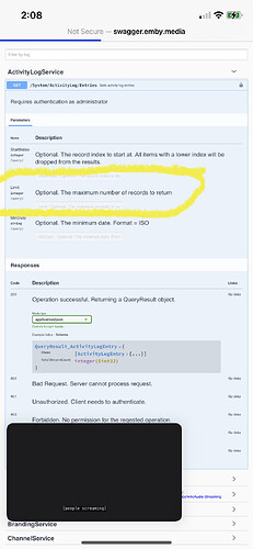

you can try the parameter ‘Limit’ with a number as the value

Ok. That doesn’t allow limiting
Here you can only filter, not limit.

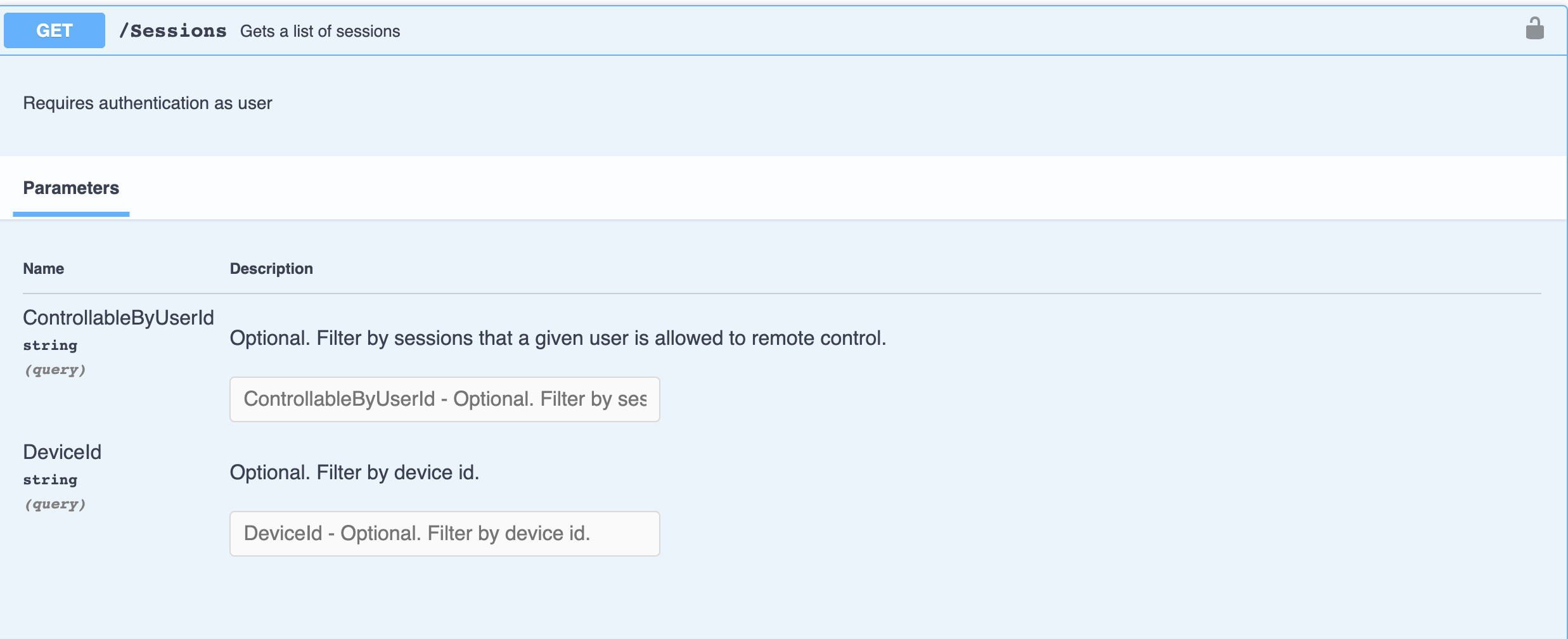

It appears that Session can only be filtered by the deviceID as shown here
