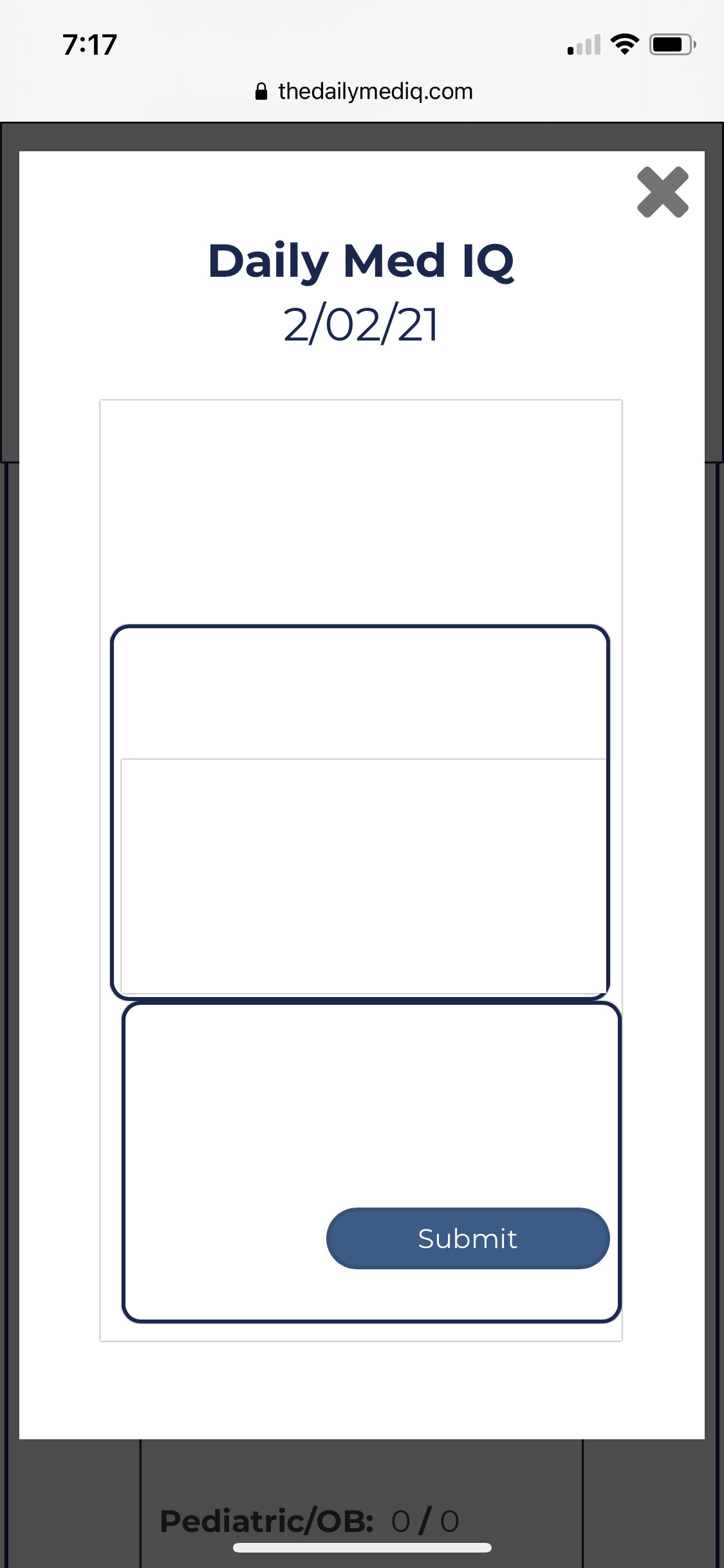

I got the same thing on my iPhone

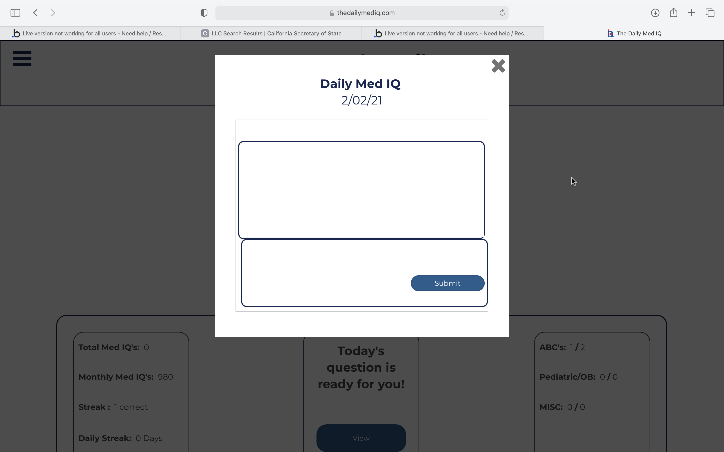

Hey thanks for responding! So i’m not sure exactly what you’re looking for, but I’ll try to explain below the process and include some screenshots and maybe that will help.
The question you were supposed to see is in the first photo, with today’s date.

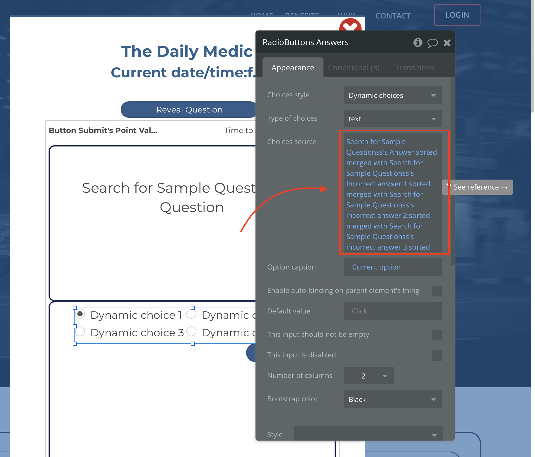

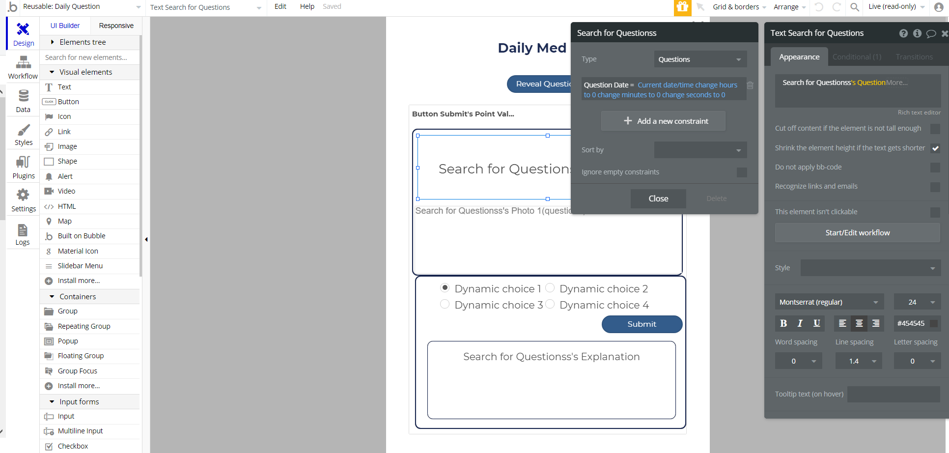

When you click “reveal” a group shows up that does a search for the question who’s date is equal to today’s date. (you can see this in the second photo)
The answer functionality works similar to the question, searching the Question databse for the question who’s date is equal to today. I checked on my end and the question worked for me. So i’m curious what may cause it to work for some users but not others?

I just checked, it doesn’t work on my laptop as well.
Definitely not internet speed. I have 500mbps/500mbps internet.

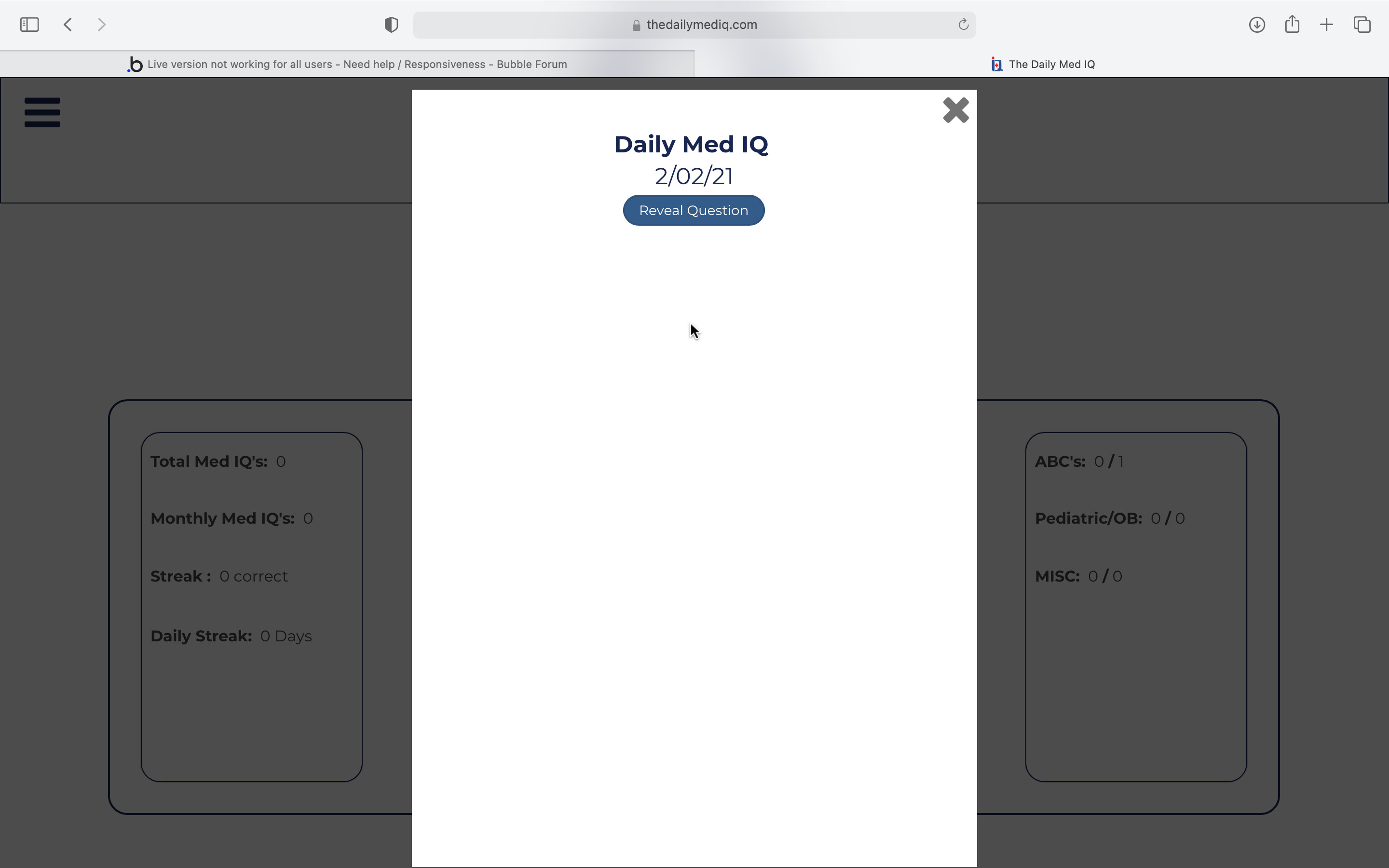

did you press the “reveal question” button? in that screen shot you shared it doesn’t look like you did, but that could just be part of the problem too. I’ll share the editor with you shortly (once I figure out how lol).

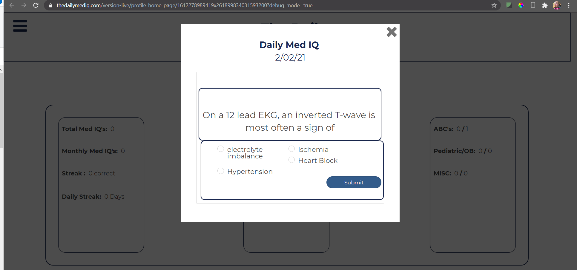

FYI, it’s working for me on both my laptop and my mobile (android) device.

Also, maybe not having to press reveal question might be a good idea. :wink:

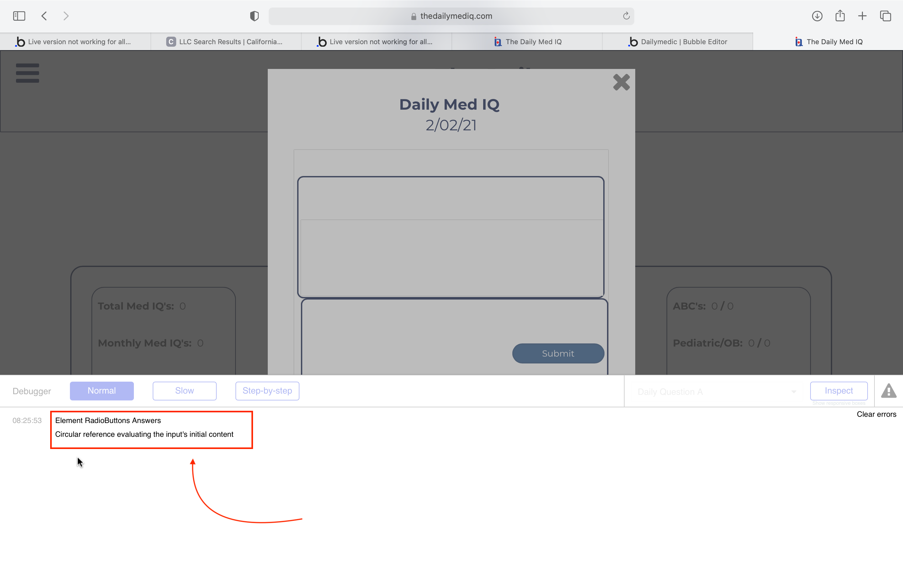

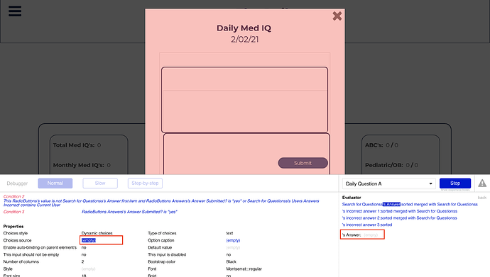

Here is one issue already, there is a circular reference, meaning it basically is referencing itself. Check that out while I look into it some more.

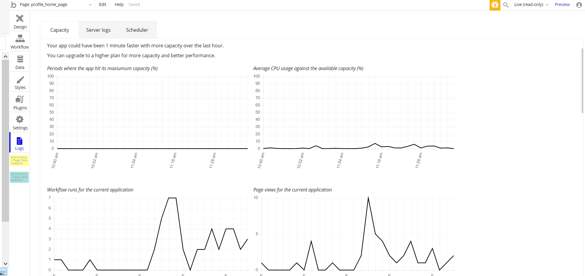

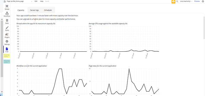

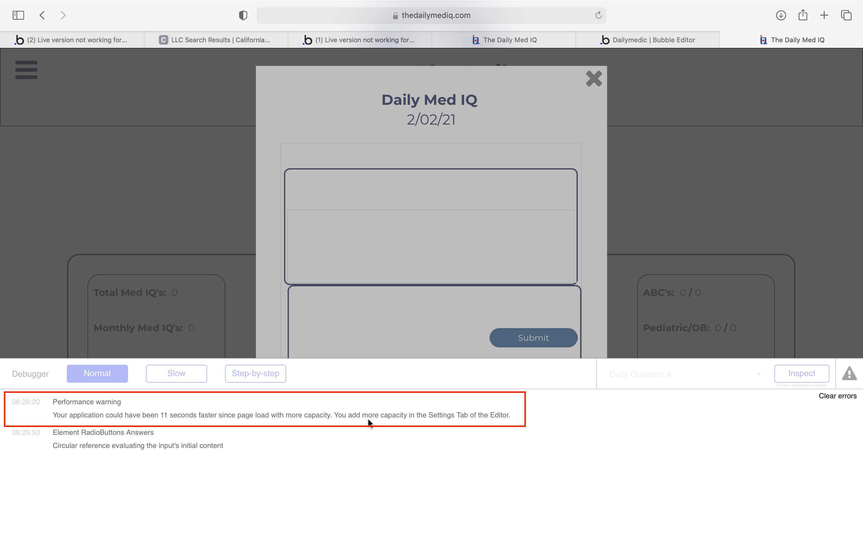

Also, seems there might be some capacity issues.
Ok that’s what I was thinking it would be initially. But on the logs page it isn’t showing the capacity as an issue? Would upgrading to the next plan increase the capacity issue?
Actually, I think a little redesign with your database source would be a better solution. Right now you are doing a bunch of searches when it would be better to just reference one field from the popup. You can do the search one time on the popup datasource, then reference that instead of doing multiple searches. That way, you save your capacity. Right now your popup doesn’t have a source, so you can do the search one time there.
Hope that makes sense. :blush:
The radio buttons are coming back empty when I do an inspect.
