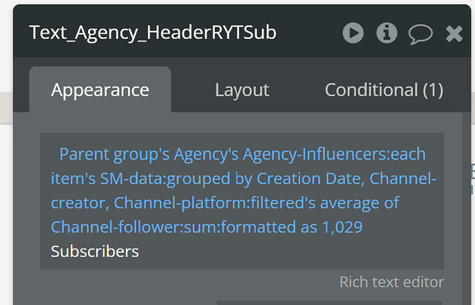

Hi- I have a data pull that is loading about 20 seconds slower than the rest of the page. How would I improve this expression:
This is what I am trying to achieve: How do you set up this expression to capture the latest data by each person? - Need help - Bubble Forum

Filtered works much slower than a pure ‘do a search’, as all the data has to be loaded out. It may be better to precalculate/store the values you are trying to show into a separate table so that you can do a simple search to pull out the data you need.
The tradeoff is that you have to calculate the change after every new entry.
ya- i think this is the best approach. I was debating on adding the latest data onto “User,” but tried to avoid it b/c “User” dataType gets too many data fields. I think your proposal is still the cleanest approach.
