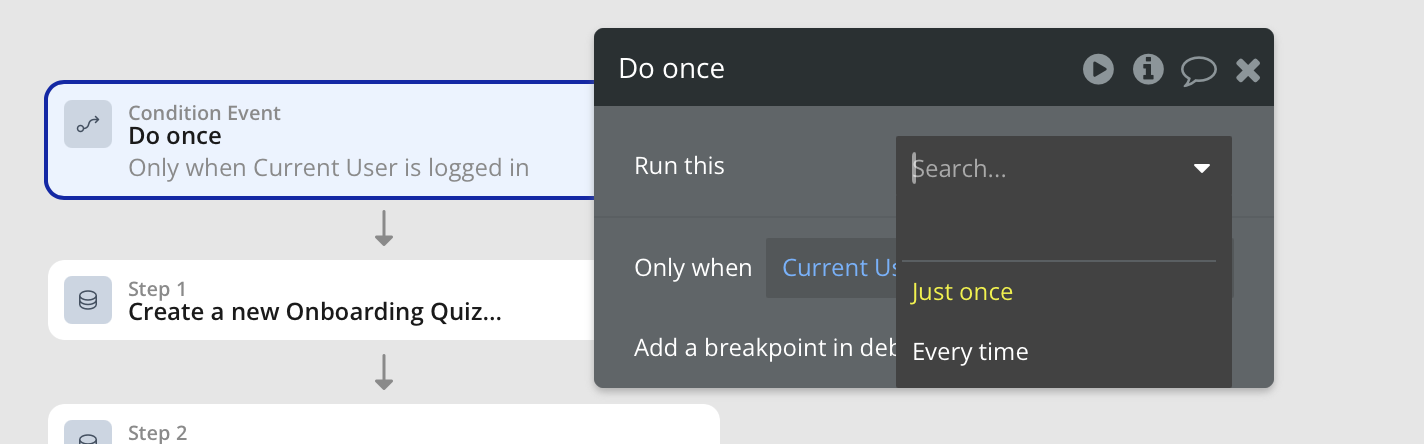

The problem in my opinion is here:
I also noticed it on my app.. I can’t really explain how and why but it’s as if I do once and current user is logged in they weren’t really working 100% on the mobile screen.. I had the same problem for mine and I looked for an alternative.. give it a try, try to remove this workflow or Anyway don’t use do ounces and I’m sure the problem will be solved!
I’ll give you an idea on the fly. Try using a custom yes/no state to tell when the user is logged in. We bet that’s how it works? Maybe someone from the bubble can give us a more technical explanation, but I repeat I also had this problem on my app and as far as it seems everything is correctly set up, so it won’t work..
Or try to move to everytime instead of just once.. I hadn’t tried this on my app.. thinking about it’s a very quick test..
Thanks for the heads up!! I knew someone from the community would be aware of a problem area.
I’ll redo it without using the Do When action and see if that helps.
EDIT: Client reported that fixed it for about half their users.
EDIT2: Nick said a fix for this went out. Haven’t gotten confirmation from my client on if it fixed for everyone yet.
