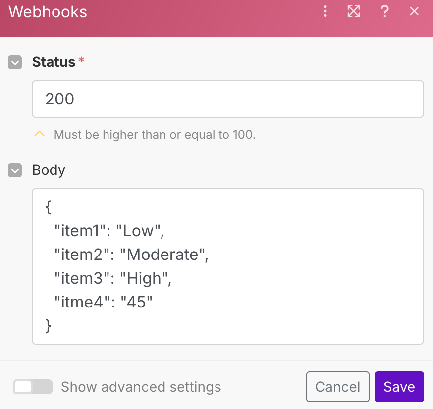

Im having trouble trying to get a response back from make.com - i have a workaround to send a webhook response but would reealy like to be able to capture this in the same workflow.

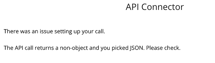

Trying the api connector with a json type gives me this error.

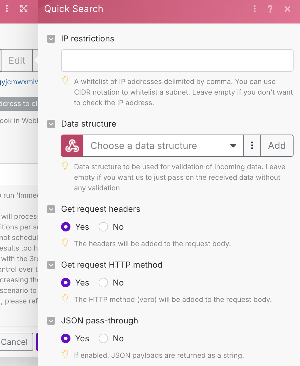

need to set your make scenario to run instantly without a queue and all end points need a webhook result
when testing the scenario must be on and not manually run also
Found the solution so @mitchbaylis you are correct - cant work this if the make scenario is sequential processing is yes (in the main scenario settings)

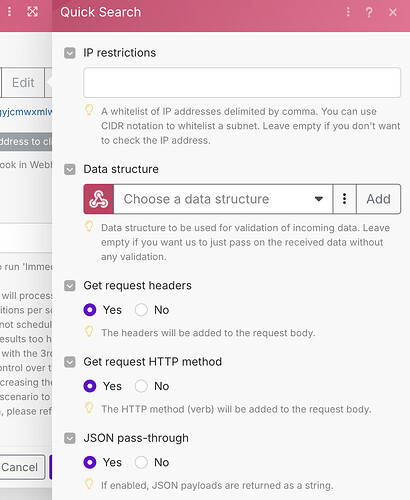

Also you need to select the json details in the webhook itself
