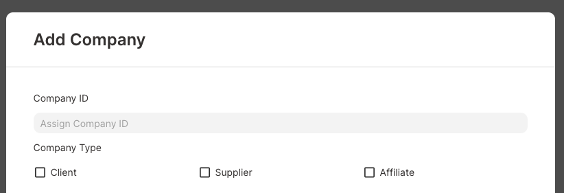

I have a reuseable element Add Company popup;
this is a popup on multiple pages, and sometimes it’s a popup from a popup;
for example:
  1. page list of sales orders > add order (show Add Order popup) > add new client (show Add Company popup)
  2. page list of suppliers > add new supplier (show Add Company popup)
    … and many other entry points like this.
The point is, this Add Company popup is in a lot of places, and I’d like to pre-tick the Company Type checkbox based on the entry point, is that possible?
This sounds like something to achieve with a data type, or data field. Add a data field to your user that defines the company type, and add a workflow to check the user’s company type when the pop up loads.
Would that work?
Create custom state in Add Company popup and set it it before showing. Based on value of this state precheck corresponding checkboxes.
Yes good idea actually, I think setting a custom state on each entry point might do the job, will test it out. Thanks.
