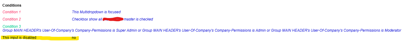

Every Multidropdown is broken with this logic:
Disabled by default
Enable is Super admin, admin, mod.
Please help

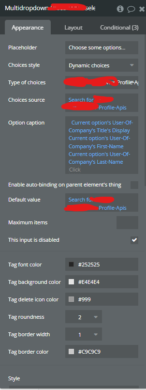

I think its recently broke as the top says disabled NO but in the properties its saying YES. This was working yesterday and nothing has been released.
Current logic thats worked for 6+ months:
-Multi Select disable by default
-If person is admin then enable
If I flip the logic to this it works. But HUGE Pain to refactor my ENTIRE APP:

My problem is now most of my app that have multidropdown are all broken… WHy would it randomly stop working. When I inspect its saying the rule is true and says its not disabled

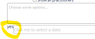

I added the login into a test field to double check and it resolved to YES meaning its true

Like the debug tool says its not disabled but the UI is.
