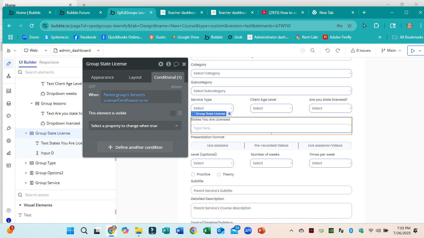

My condition to hide the next question is not working

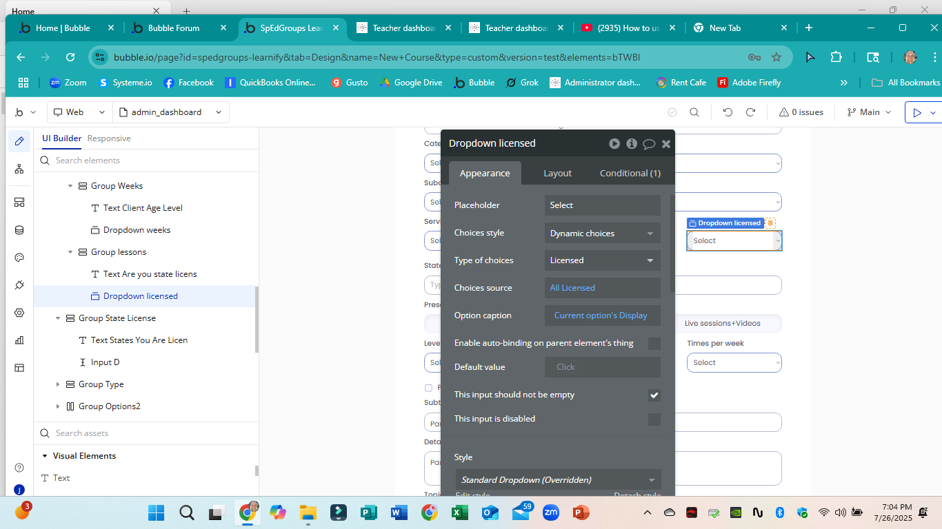

I want the form to respond to the answer given in the drop down. It is a yes/no option set. If the answer is yes (licensed), then I want the next question to be visible, or it could work the other way too (not be visible until the answer is yes). I’d be happy with either one. I’ve asked the Bubble bot and followed directions exactly both ways, but it’s not working either way. I tried it in incognito too, and it’s the same. Do you see what I’m doing wrong?
To clarify, it will be visible or invisible when loaded. That part is working. But, when yes or no is selected nothing happens to the second question.
Shouldn’t you change the condition for ‘Group State License’ from ‘Parent group’s Service’s License/Certification is no’ to ‘Dropdown licensed is X’ instead?
Success!!! You are right! Thank you so much!!!
