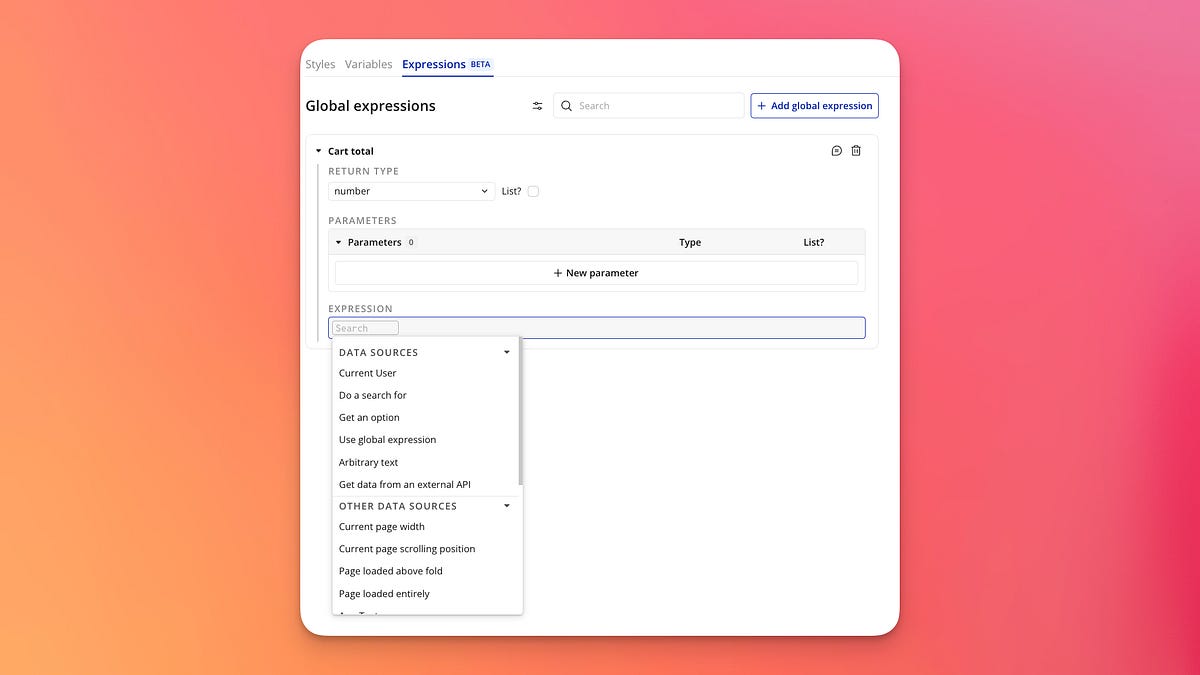

  • Privacy rules handle the data layer
  • The global expression becomes part of your app’s source code, as you can see below in the dynamics.js file (Cart total is the expression), so no sensitive data in the expression itself.
  • I didn’t see the original thread, so not sure what the question was, but take the same precautions as in every other part of your app. No sensitive data outside of the database, API Connector and backend workflows.

Meaning, the value of ‘cart tool’ itself is not visible in the code?
