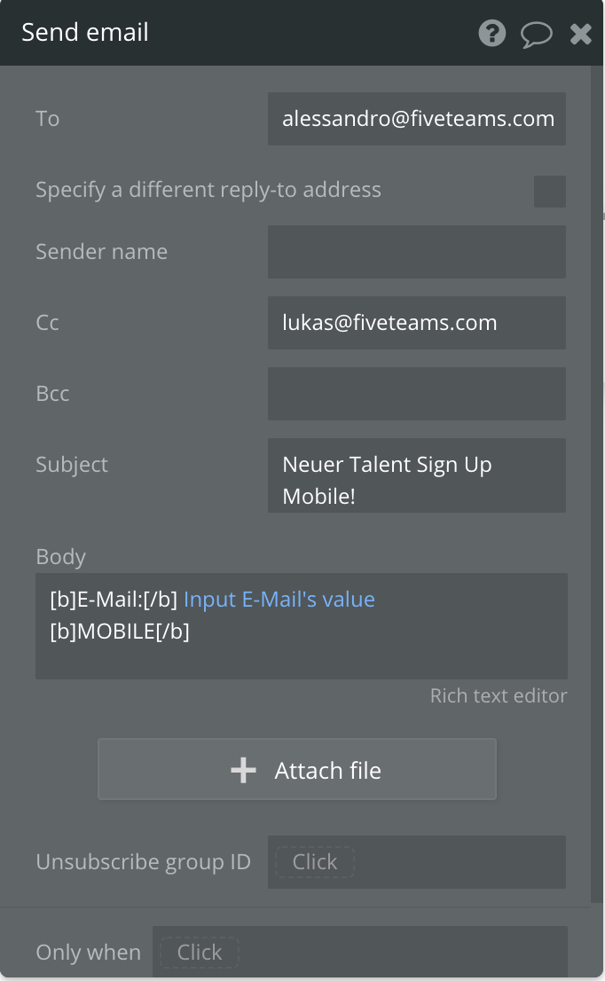

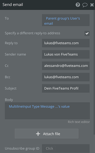

Now, in my app (app.fiveteams.com), the send email workflow is buggy. It goes out to the recipient but although I am in CC or BCC with my gmail adress (alessandro@fiveteams.com) I do not receive the mail copy. When I am the recipient, I do not receive it at all.
It looks that after my email was shut down for 2 days, my mail is kind of “immune” to the send email workflow. Here I use the default one offered by bubble.
Do you have any idea how i could fix the issue?
I tried to:
  • redeploy app
  • check gmail mail filtering options
  • delete workflow and set it up again
Here are two screenshots of my workflows:

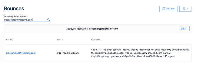

Just following up in case someone has the same problem:
My mail domain was on the bouncelist of bubble´s sendgrid account.
I talked to the bubble support team and they were able to delete me off the bounce list which finally solved the problem.
