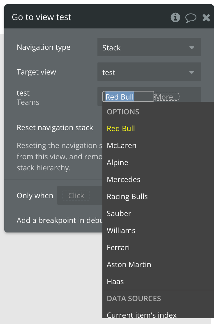

You need to type in the name of your view in the dynamic data expression and you will see the property there. In my case I have a view called “Test” with a Property called "F1 Team.
In the above:
  • “test” is the name of the view
  • “F1 team” is the property

Can’t seem to figure out how to send data in a Workflow to navigate from a selectable list to a different view? Looks like you have one extra field than I do…
Figured it out. You need to create a New Property in for the View. Then when you navigate to that view you can send the data to one of the properties you setup for that View ..
