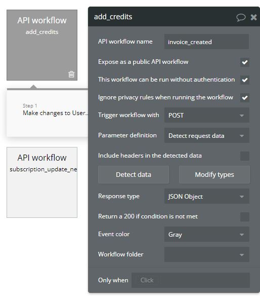

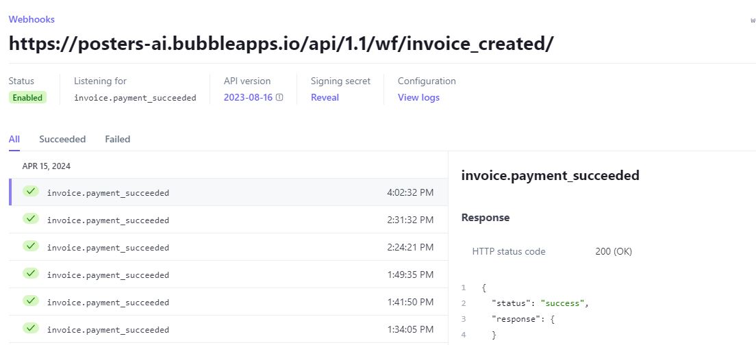

Sure,
Step 1: Current user subscribes to a plan and then workflow makes changes to current user, takes customer ID , status etc.
Step 2: After payment is succeed stripe generates an invoice and i’m catching specifically invoice.payment_succeeded event.
Step 3: Backend Workflow catches (or supposed to catch) the event. I initialized event again just to show that backend workflow actually catches the webhook when it sent directly from Stripe.
The Request Data’s object customer needs to be populated…check your Stripe logs to see if the webhook sent that value or not…and share the screen shot of the entire webhook sent as there are multiple locations for customer data to be sent and Stripe has become more difficult to work with because of this

Hi, i’m not sure 100% , but looks like stripe getting customer ID

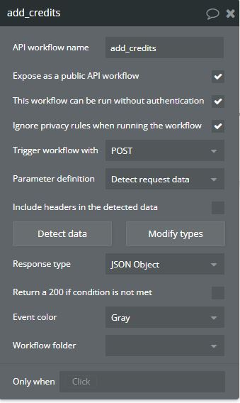

Hi, I tried to implement the steps you provided, but I encountered some difficulties with scheduling API workflows. When I attempt to schedule the API workflow, “update_sub” is not a possible option to choose after selecting “Parameter definition: Detect Request Data.” Perhaps I need to keep it in manual definition?
Are you trying to pass the whole webhook from the webhook to the api workflow? If so, I wouldn’t do it that way. Just define the parameters you need on the api workflow, (for example, cus_id), then in the webhook just get that value from the response data and pass it as a parameter to the api workflow. Don’t pass the result of step 1 as that will sometimes be empty
Do you mean defin parameters in that way ? If yes i had one set up already for subscription cancelation which works just fine.
And another one i had set up in the same way but for Credits but it not works.
I can’t tell what’s going on here from the screenshots you posted. What exactly is giving you trouble in implementing the solution below?
I think you was right, I made some tests and when i’m canceling the subscription and then subscribing again backend API workflow adding credits. So i think there is a solution in scheduling API workflows. However im new in bubble developing and i don’t really understand how to schedule webhooks, maybe there is some articles or tutorials how to do this?
