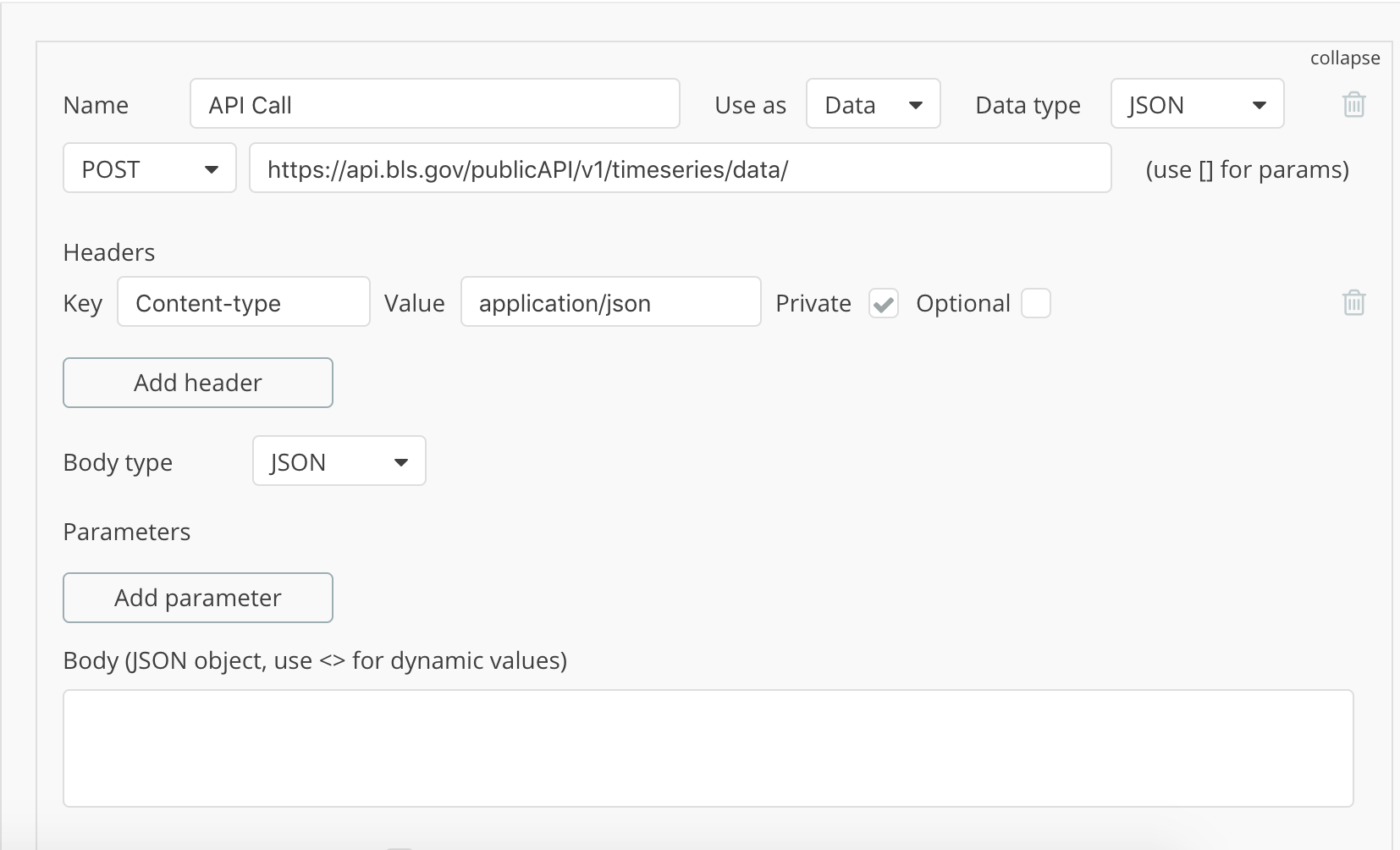

Need help with Bubble API Connector
I’m trying to use the Bubble API Connector plugin to connect to an API from the Bureau of Labor Getting Started : U.S. Bureau of Labor Statistics
I’ve been able to connect when initializing the call, but haven’t been able to retrieve any data. I’m not sure how I’m supposed to configure parameters to make it successful.
Here is what I have so far:
Also, here is some sample code in Python from their API documentation, I just don’t know how to recreate this using the plugin.

Can anyone help please?

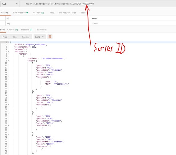

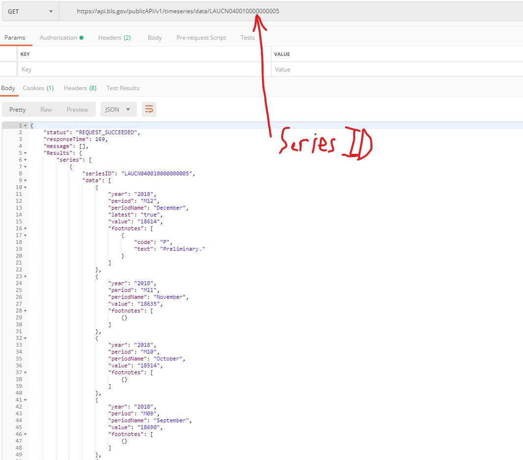

@trenton Try like this
@trenton Use @neerja 's solution. You were just missing the Series ID at the end of the URL.
From the API doc:
