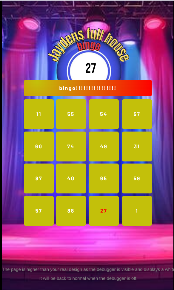

hi all i need help with this so i’m making a bingo game and i need it to be when the user playing get a full house (tick off all of the boxes ) it will get all of the numbers and add then into a database as a list but only if the tick off all the boxes if they haven’t a message will display
so here is what the game looks like

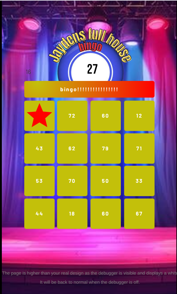

when they click on a box the star will appear (marking that it has been ticked)

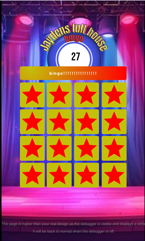

when they have ticked all the boxes they will click the bingo button

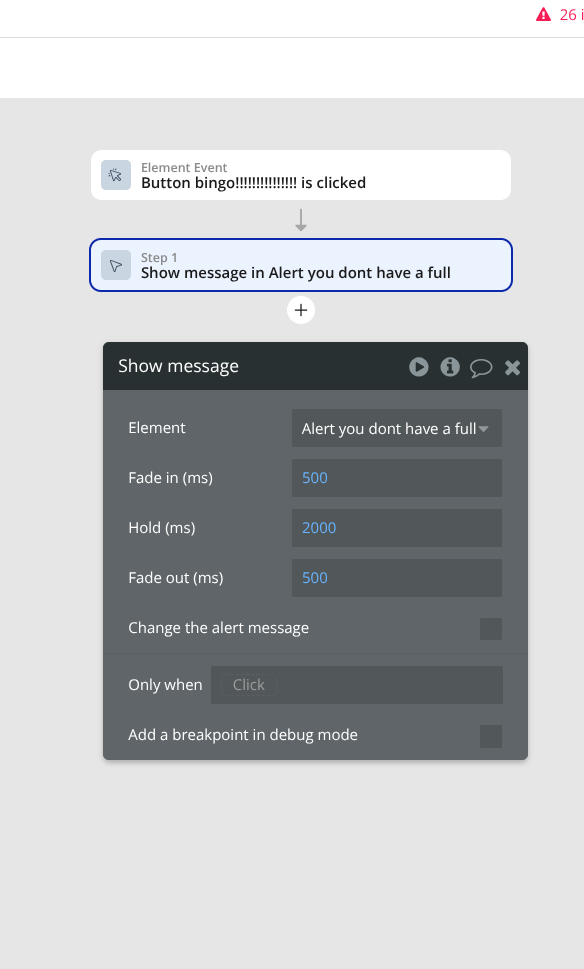

when they click the bingo button if they have ticked all the boxes the aboth will happen if not the below will happen
so i need help as i don’t know how to make it tell that the user has ticked all of the boxes and i also need help as for some reason when it tries to create a list it only adds one number and also in the wrong list i need it to be in the bingo list not the BW list

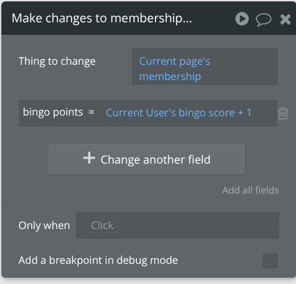

hi thank you for that i have run in to my last problem
so i got it that everytime they click the button it will add a +1 to the score when they get 16 they system knows its a full house but for some reason is not adding + 1 to the DB
Screenshot 2025-01-23 08.12.16
if you can see its only changing the number to 1 not adding +1
