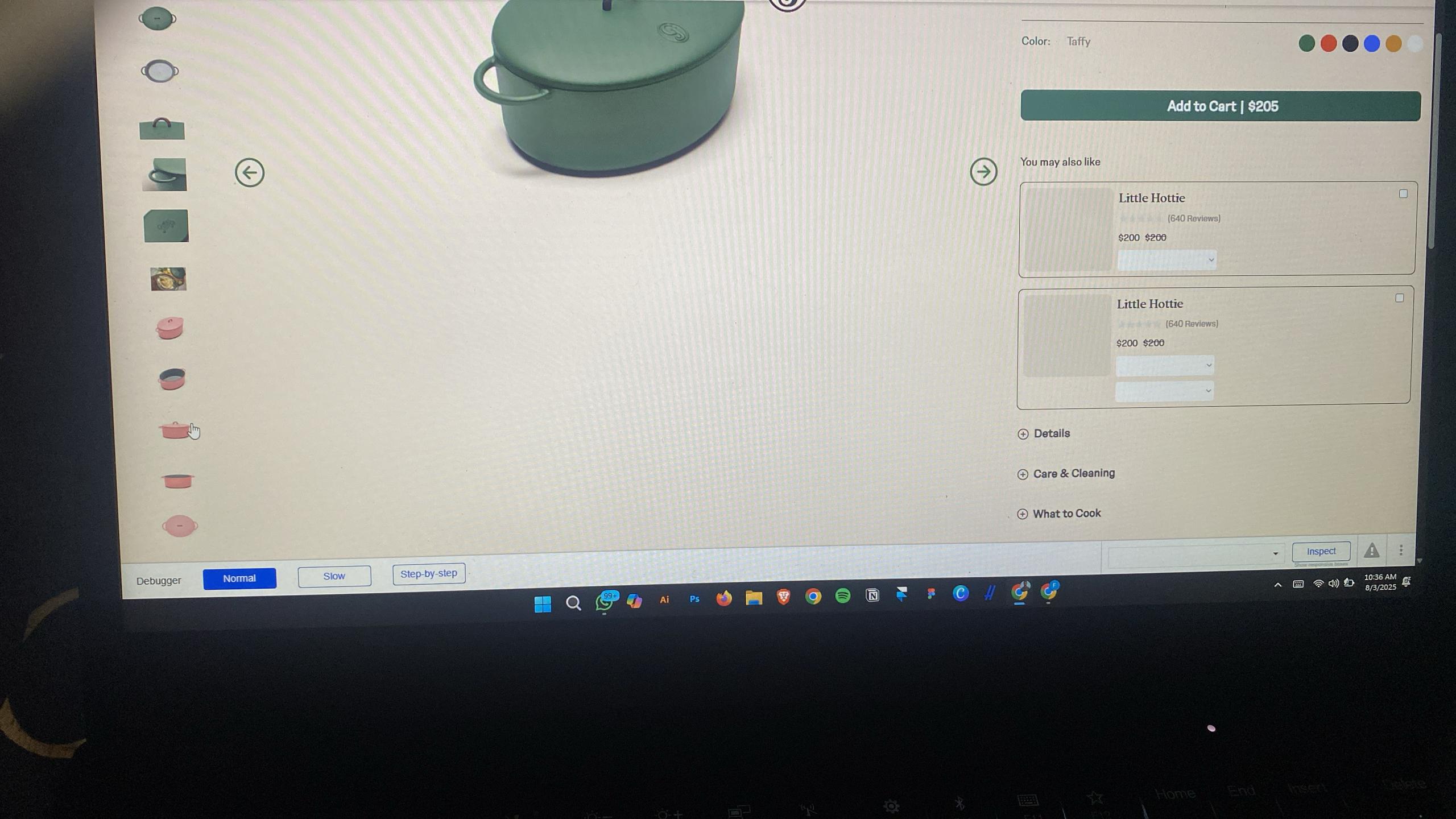

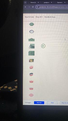

Hello everyone i recent just started learning bubble and recreating my first ever store webapp i stumbled on. how ever i need some clarifications on my database structure, i have product datatype and a product variant datatype. Because of a product variant having lots of product variant images i decided to create the product variant datatype with a field variant images (list of images) and then it was linked back to my product datatype as list of product variants. when i try to retrieve each variants images it tends to bring back all list of product variants across all my appdata fields. but i only want it to return certain product variant in just a particular field. this is what my product variant appdata looks like
it returns all variants images but i want it constraint to just the list of images in a field

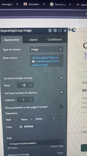

this the expression for the RG

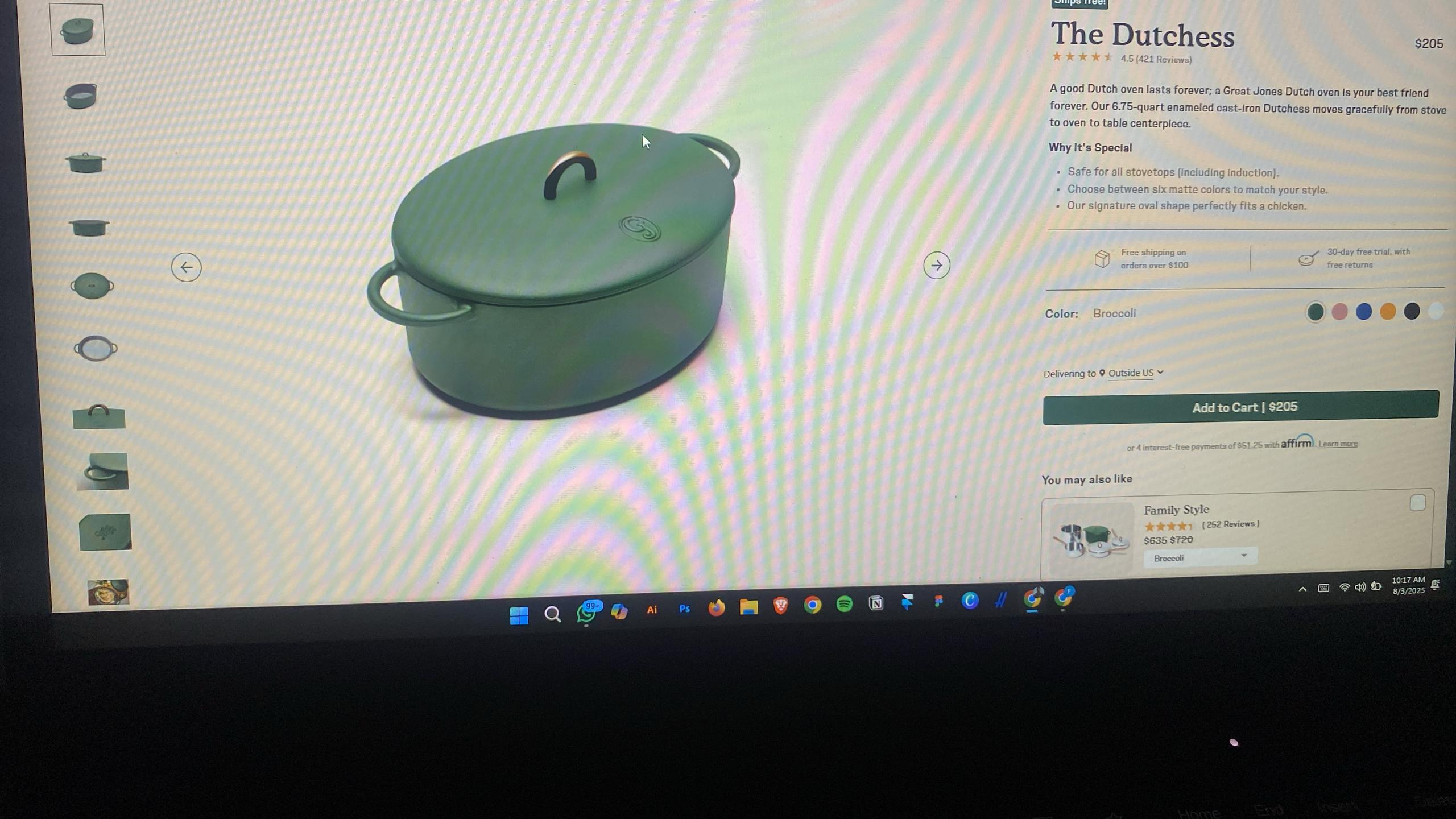

No i’m displaying this data, please hold on while i show you the reference website
Here is the product product page, each product have different color which was named in a way that the user recon with instead of the conventional color names (eg broccoli=green, salt=white and so on). I created option set for each product color type (variant) with the attribute “color” of the type text to store the hex code of each colors. if you take a look at the image left side you will see the list of colors each product has, i was able to achieve this using shape and giving the shape background a dynamic color of each option set attribute. now depends on the selected color, the feedback give the images of the color selected. are you understanding it sir/ma’am?
With the use of some logics and customs state i was able to achieve this, but the problem lies in the expression returning all images across all fields in my App data instead of returning images in a particular field.
You have to add :filtered to the rg of imagrs and filter by the variant_name - this is likely going to be dynamic, based on the option set for the variant names
More than one product can have the same variant_name filtering by the variant_name will return all the products associated with that name whereas I’m working with just a product and its variants per product page view. I’m thinking of filtering by the ID of the field I’m interested in but I don’t know how to go about this.
Or maybe introduce unique slug for each field.
You already get → this pages product variant images, but you dont want all variant images at once right? So you have to filter them by the variant_name.
