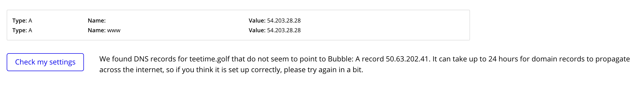

Trying to role back because can’t get GoDaddy to work and get two A record IP addresses to use - which one is correct? Is this a Bug?
I got it back last night, and I met this bug. I tried starting with 54.203.28.28, it works.
Thanks Eren, that was the solution - use the ones in the image not the one in the text
