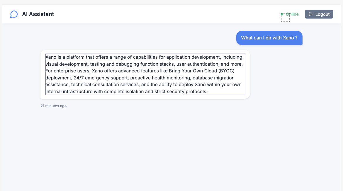

Hey! When I configure the API call in the Bubble API Connector with Data type: Stream, Bubble only detects one chunk and assigns it as a text stream, not a proper list of objects.
What I’ve tried:
Streaming via Streaming API Response in Xano
Returning a list of JSON objects with correct formatting
Manually entering the sample response in Bubble (still parsed as a text stream)
Splitting the response in Bubble using :split by (|)
Setting the rg type to text, but then I can’t access nested fields like question and response per item
What I want: To display each question/response pair inside a repeating group with proper access to each object’s fields (as you would with a regular API response).
Is there a recommended workaround to turn the streamed string into usable structured data within Bubble?
