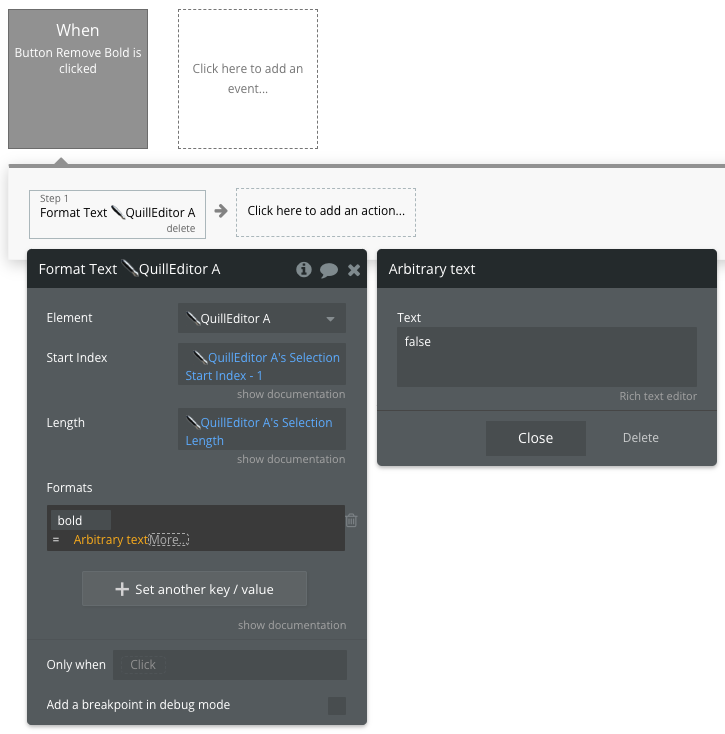

While there is no direct feature for this specific use case, you can utilize the Format action to strip formatting from the editor’s content.
For instance, in this page we have the foramt action to remove the bold formatting from the selected text, you can apply the same method to set the color to black or to clear other formatting styles.

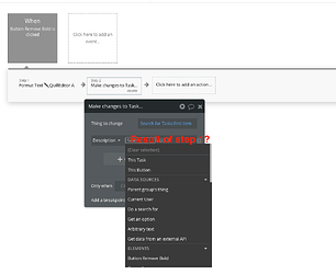

  1. Where can I see when the text was changed or how can I access the changed text? When I execute the workflow, the text remains identical.
  2. In my understanding I need a workflow that first changes the entered text according to my criteria and then saves the changed text.
    Something like that? Or is there a CS for the QuillEditor that saves the changed text?
  3. is it possible to build the workflow in such a way that I can save the changed text as HTML?

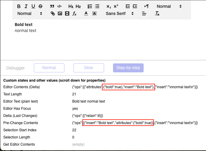

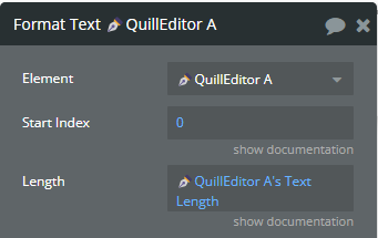

You can utilize the event that is triggered whenever there is a change in the editor:
In the example, we modified the format of the user-selected text. If you wish to change the format of the entire editor’s content, you could adjust the action field accordingly:

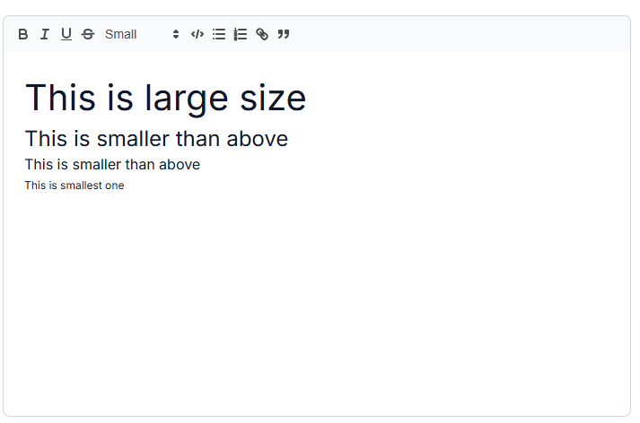

Thanks for getting back. So here is the HTML generated by the editor:
<p><span class="ql-size-huge">This is large size</span></p><p><span class="ql-size-large">This is smaller than above</span></p><p>This is smaller than above</p><p><span class="ql-size-small">This is smallest one</span></p>
I think the HTML should also contain attribute/details of these classes inside style tag.
Hi Shuvam,
You are right; it appears that the HTML is not compatible with certain formatting since it generates classes rather than CSS styling attributes.
I will undertake research to find a resolution to this issue. Apologies for any inconvenience you may have experienced due to this problem.
Yes please. If you can generate CSS attributes then that would be awesome.

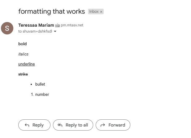

In the image you can see the ones that are working:

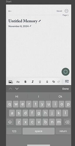

hey @NoCodeDataArtisan im checking this plugin and there are a few things that i need to confirm before i move ahead with this.
Is it possible to have the toolbar at the bottom like this: (if so, how)?
Also, how can i style the toolbar and editor the same way as shown here?
Is there an option to resize picture and videos and can i add captions to pictures? Please let me know. Thanks!
Hello @idanishsheikh,
I hope you’re doing well.
The plugin itself does not have a built-in feature to move the toolbar down. However, it might be achievable with custom code.
You can customize the toolbar items directly within the Bubble editor. Please note that the plugin also does not include a resize feature for images and videos.
