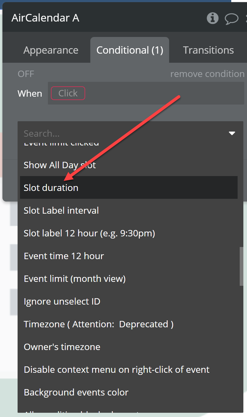

I would like to be able to lower the slot duration so that small events are easier to see on the calendar when some sort of ā€œexpandā€ button is pressed. I can’t figure out how to make the calendar change the slot duration. I have tried adding in ā€œre-render calendarā€ and ā€œre-render eventsā€ workflow steps, but it doesn’t help.

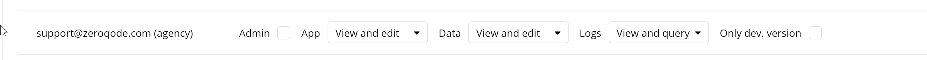

Would it be convenient for you to add our mail: support@zeroqode.com as a collaborator of your app?
That will allow us to check/compare your setup and test it out in our workspace.
Enter your Bubble editor page → Settings → ā€œCollaborationā€ tab → Invite a user (email).
(Note: disregard the warning message regarding the plan, as we are an agency and you can easily add us to your collaborators.)
We will check your setup and do a few tests in an attempt to find the root cause and help you fix it. In case it is ok for you, please let us know.
Unfortunately, the current plugin functionality doesn’t provide such an option.
We will check how feasible it will be to add the requested feature to the future plugin update, thank you for suggesting it.

Perhaps you should remove it from the list of features in the conditional menu dropdown:

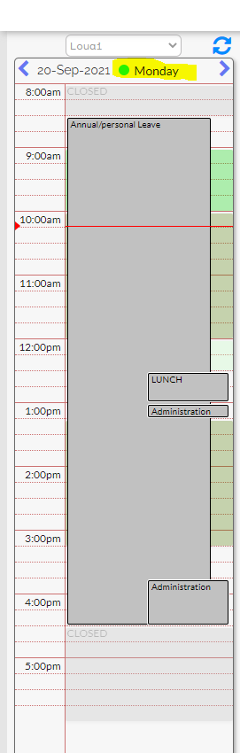

The day on Air Calendar references GMT, not the timezone I assign via Workflow to the Calendar. So my day is wrong until it hits GMT 12:00 am, which currently is 10am my time. Unfortunately, I took this screenshot after 12:00 am GMT. I only realized what was going on after spending an hour trying to troubleshoot why this was happening.

I will have to wait for tomorrow morning when I am in a new day based on my AU/Brisbane timezone and GMT is still on the previous day.

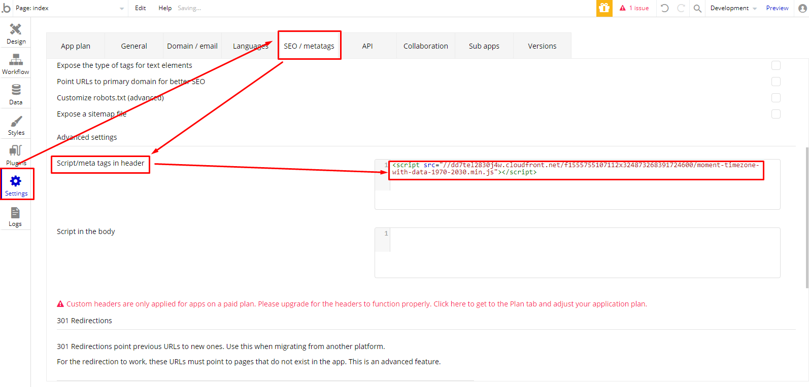

Hi @avern87 & @David_Copperfield. thanks for your patience.
During our investigation, we’ve found that the error appears due to plugin element script load speed. Our developer team is working now on a solution.
As a temporary fix, please insert the following script in your application header:
<script src="//dd7tel2830j4w.cloudfront.net/f1555755107112x324873268391724600/moment-timezone-with-data-1970-2030.min.js"></script>
Please let us know if the provided temporary fix helped in your case.

Here is a screen recording of the issue as well my my idea for replicating the issue: Screen Recording 2021-09-21...
I then waited until we got closed to 12am GMT and recorded this video to show how the calendar changes when the GMT clock stikes midnight: Screen Recording 2021-09-21...
