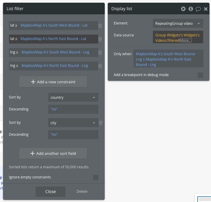

And then secondly, I would love a state to know which Marker IDs are in the viewport of the map. I would like to build something like an ā€œAirbnb-styleā€ map and then filter based on what the users sees. I know that the Zeroqode plugin has that state, but I just like your Plugin better :smiley:

You can figure out which markers are visible on the map (and get their associated marker IDs) by using the 4 exposed states outlined in the below post:
You basically need to do a search for all locations where the lng/lats fall within the bounds given by these custom states. Let me know if that makes sense or if I can clarify further :slight_smile:
Thanks for the update, looking forward! I got the search within bounds to work as well
Beautiful. Thanks for confirming @a.villabruna and will keep you posted on progress with the ā€˜Change Icon for Clicked Marker’ update!
It might be interesting for others to know how I implemented this. There is some complexity due to the crossing of international date lines. See below screenshots with the scenario where the Map bounds are crossing datelines (with the advanced filter), and where it doesn’t cross datelines.

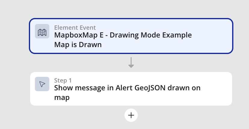

Greetings!
I’m building what I assumed would be a straightforward GIS app for one of our customers, but I feel like I’ve hit a wall. What I’m trying to do is simple -
  1. User draws a new feature while in draw mode. This can be either a polygon or a point.
  2. Once the feature has been drawn, a workflow is triggered, setting the value of a custom state that determines the visibility of a form overlay. In this step, the value is set to ā€œtrueā€ thus making it visible to the user. With the form visible, the drawing controls should be disabled so that there can be only one geoJSON per record.
  3. Once the user completes the form, they click a button and a new record or ā€œthingā€ is created that contains the form data along with the point/poly geoJSON.
I’m currently held up on step 2.
Attempted workarounds:
Using the ā€œstandardā€ Mapbox plugin, I was able to accomplish this by using the ā€œA MapBox Map Polygon is Drawnā€ event as a trigger. However, that doesn’t appear to be an option in this plugin. I eventually came up with what I thought was a clever workaround - I would create a ā€œlistenerā€ for each of the two feature types that trigger when the user creates a new feature. The idea was to check whether the map’s geojSON state (s) were empty, and use the ā€œClear geoJSONā€ event to reset the states between each iteration. While implementing this, I quickly learned that the geojSON map states hold data from the most recent drawing of that type and the data can’t be ā€œresetā€ so to speak, only overwritten. Clear geojSON only appears to remove drawn features on the map, but doesn’t clear the actual states. The result is that my implementation worked flawlessly… once.
I also tried setting the initial value of an input to reflect the map’s geojSON states to trigger a workflow when the value changed. This would typically indicate that a new feature has been drawn on the map so it seemed like a good plan, but… for some reason I couldn’t get the event to trigger even though my inputs were updating without issue. The only way I could get this to work was by manually changing the values myself.
If all of that sounds like a mess, it’s because it is! I could elaborate further, but this post is already starting to look like an essay. And besides, the word ā€œgeoJSONā€ has to be the most annoying word to type, and I’m not sure I can take much more of it. It’s entirely possible that these hurdles stem from user-error on my part, so if any experienced bubble/mapbox devs out there can tell me that I’m an idiot and that there’s an existing solution, I would welcome any input!
Thanks in advance and let me know if I need to clarify anything.
Cheers.
Hi @thesaltiestsalsa, thanks for your interest in my plugin!
The Beautiful Maps - Mapbox plugin has an event called ā€˜Map is Drawn’ that gets triggered whenever a user draws on the map.
I’m not familiar with the inner workings of the other Mapbox plugin you tried, but I suspect it works in the same was as their ā€˜A MapBox Map Polygon is drawn’ event.
Hope that helps and if you’ve any other questions let me know :slightly_smiling_face:
