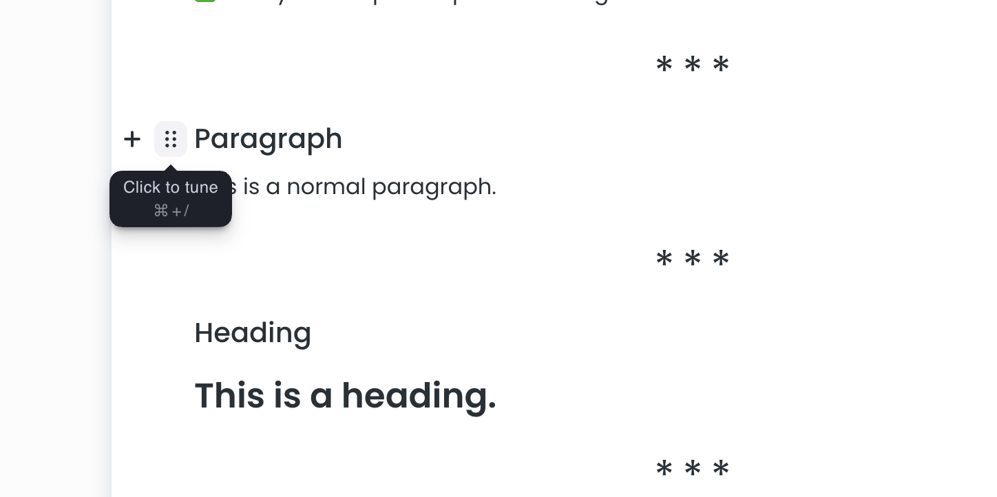

@a-hongo Just enabling the checkbox should make it work! After you have enabled “Enable reorder by drag and drop?” you can click and drag the tune icon:
to reorder the blocks.
You can try it out on the demo page: Modern Rich Text Editor (Editor.js)

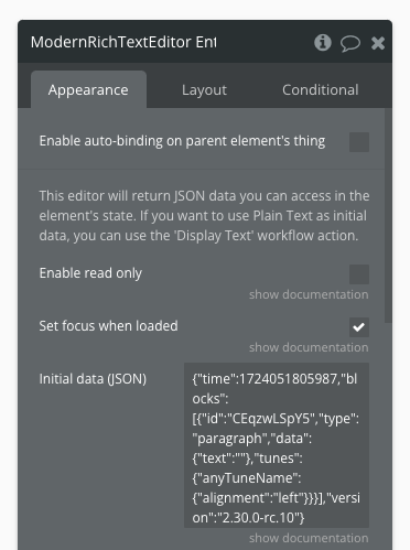

Hi @Thimo , thanks for your reply.
If the initial value is left empty, drag and drop does not seem to work.
It worked if I pre-populated the initial value with JSON (e.g., paragraph block) while enabling the checkbox.
スクリーンショット 2024-08-20 9.55.10
@a-hongo ah good catch! I was able to reproduce and fix the issue. However I have not released a new version yet as I am also working on some bigger improvements that will be released at the end of this week / beginning of next week. So you can expect this fix to be included in that update :slight_smile:

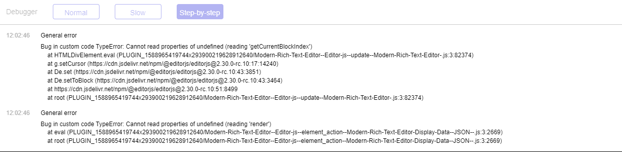

Hi @Thimo , I have an error.
In my application, I register a text. This text goes to a database field in JSON format.
However, when I want to display this text from the database in my application using the text editor’s reading mode and it has an image, I get this error.
Do you know what it could be?
Hi @dimasferreiraed
As the error indicates your JSON is not correct. Please make sure the JSON you are trying to display has the correct format the RTE supports. It should be the exact format the RTE also outputs.
