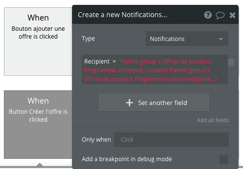

    Now I’m working on a notification sign for user when a new offer is available, they get a notification sign accordiing to their program.
    I created a notification data type with a recipient field.

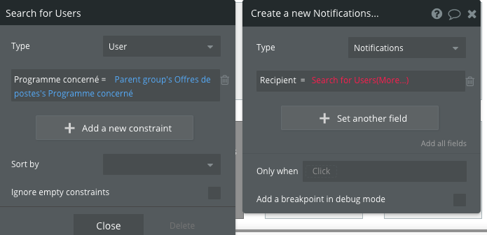

    Where i’m stuck is on the workflow, when i have to select the recipient to add a notification, I can’t select users according to their program (see attached).
    I tried 2 things and constraint, but it’s still in red :wink:
    Is it possible to notify user according to their program ? or am i missing something ?
    many thanks
    Screen Shot 2021-09-11 at 13.09.31
Il manque “firts item” non ? Parce que ton “recipient” a l air d attendre un seul item et tu lui sers une liste
Edit : si tu veux creer plusieurs notifs, il te faut creer un api workflow que tu trigger avec “trigger api wf on a list”.
