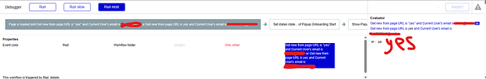

Actually just today noticed very strange attitude of “or” expression in condition

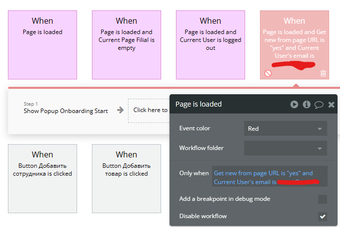

I have a straight text condition on user email - just for the reason to deploy without not completed part of app.
Yesterday it was working well, but today a see the following:
This condition is passing well but doesn’t fire popup open (
The same time condition without “or” statement works well
Am I missing smth ???
The condition is being evaluated as false…

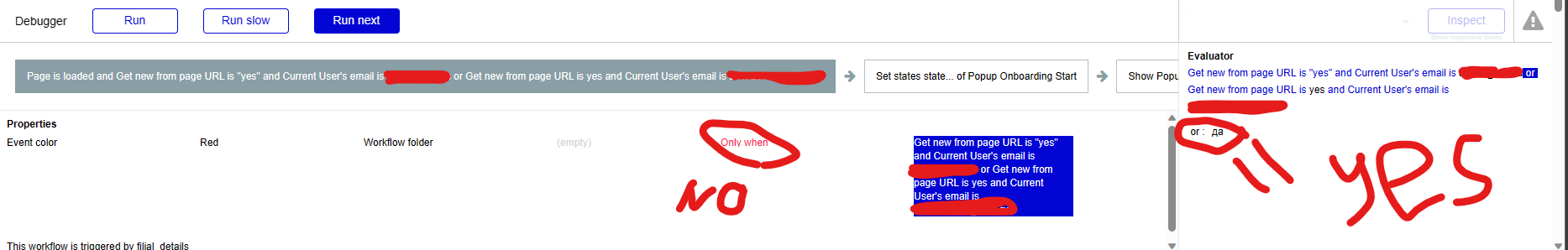

“or” condition evaluated as True, but whole condition for trigger evalueted as False
Yes I know (I can see that)…
What is the issue? (are you saying it’s being evaluated incorrectly? - in which case how do you know that?.. do you have any other screenshots?)
Yesterday all was working correctly, same inputs gave success

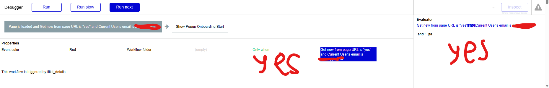

To be sure, I cut off false condition and run it successful
And yes - I can say that it was evaluated incorrectly, because “or” should evaluate as True if any of condition in line is True
One more attempt to ensure
I place the same email in both conditions - it fires well. For me it seems working incorrect when this emails different
Am I missing or treat smth wrong?

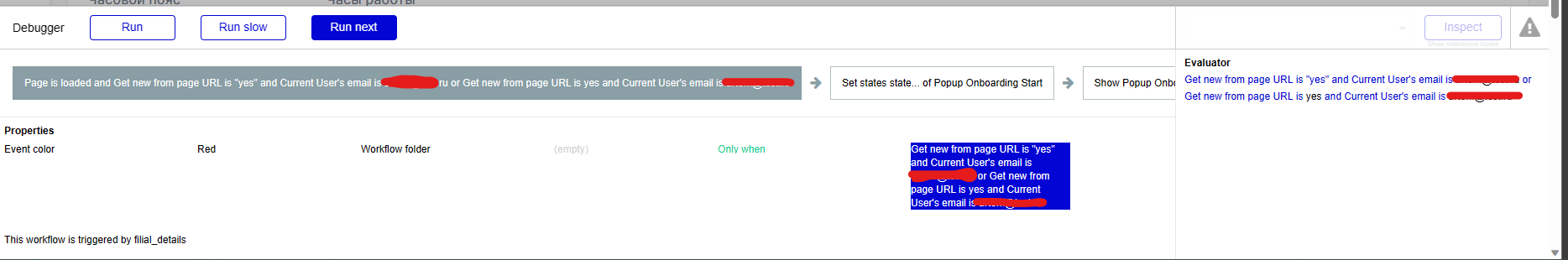

Mind flow as follows:
(true AND true) true (true AND false) == true
(get new from url is yes and user email is test@test.com) or (get new from url is yes and user email is test2@test.com) = false
this is wrong as I think
Why would true AND false equal true? (it doesn’t, by the way)… I think that’s where your confusion is coming from.
Hmmm…
Actually, all the way I was thinking that this right:
(True AND True) OR (True AND False) == True OR False == True
You are telling me that it should be treated as:
(((True AND True) OR True) AND False) == ((True OR True) AND False) == True AND False == False
That can be the reason - but the problem is that yesterday was the first case, today is the second case

Are you using the parenthesis experimental feature? If you aren’t then you should.
Thanks! I see this feature - will try next time, I’m not alone in development team here, somebody will not be glad for this for sure
