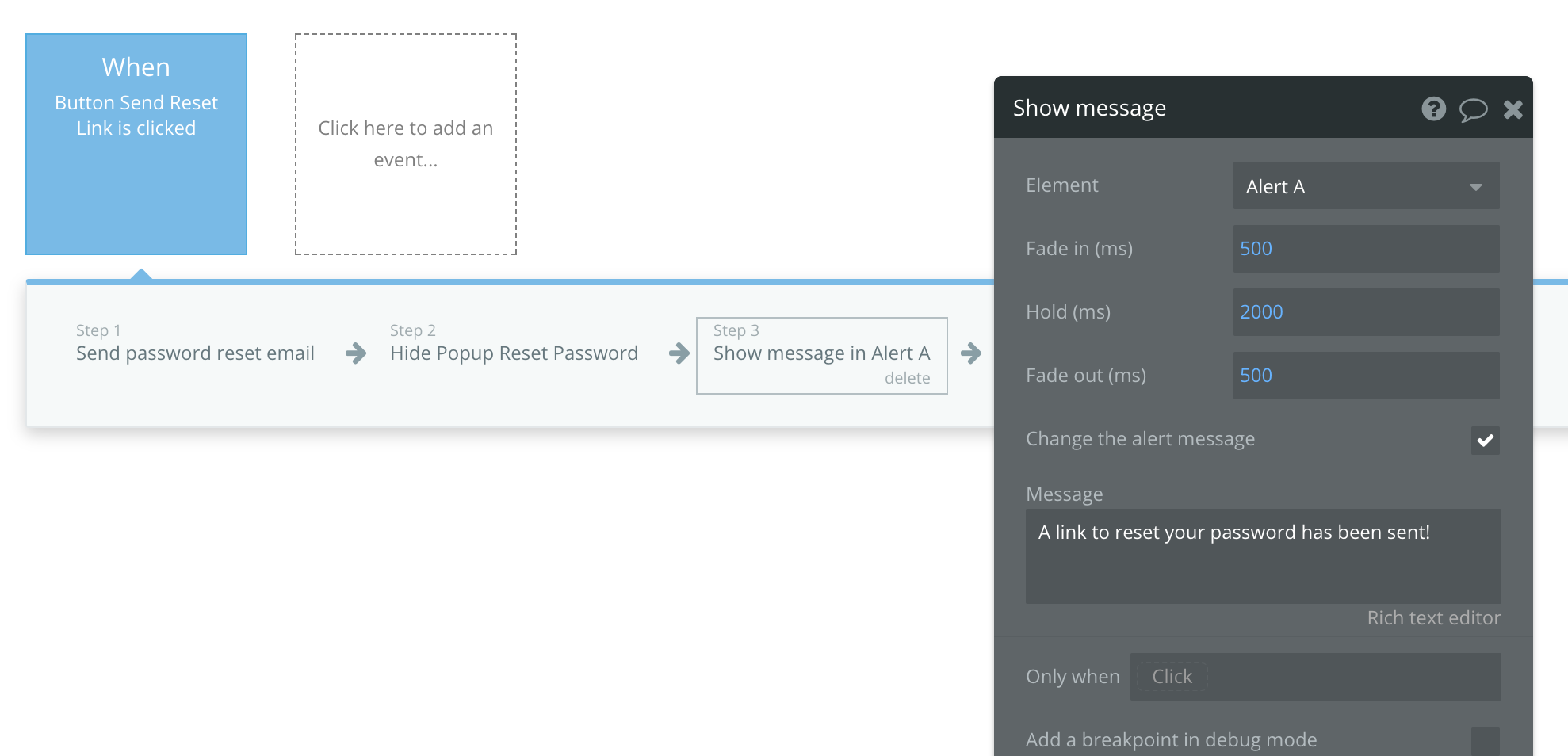

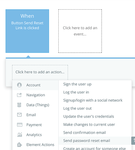

Hey @swvann :slight_smile: Are you referring to the workflow which occurs when the Reset Password button is clicked? If so, you could have the workflow be:
Then, once you have the first action as ‘Send password reset email’, you can have another action which closes the popup, and (if you prefer) show an alert to the User that the reset link was emailed to them:
Once the User receives this link in an email, they’ll automatically be directed to the reset_pw page within your app.
