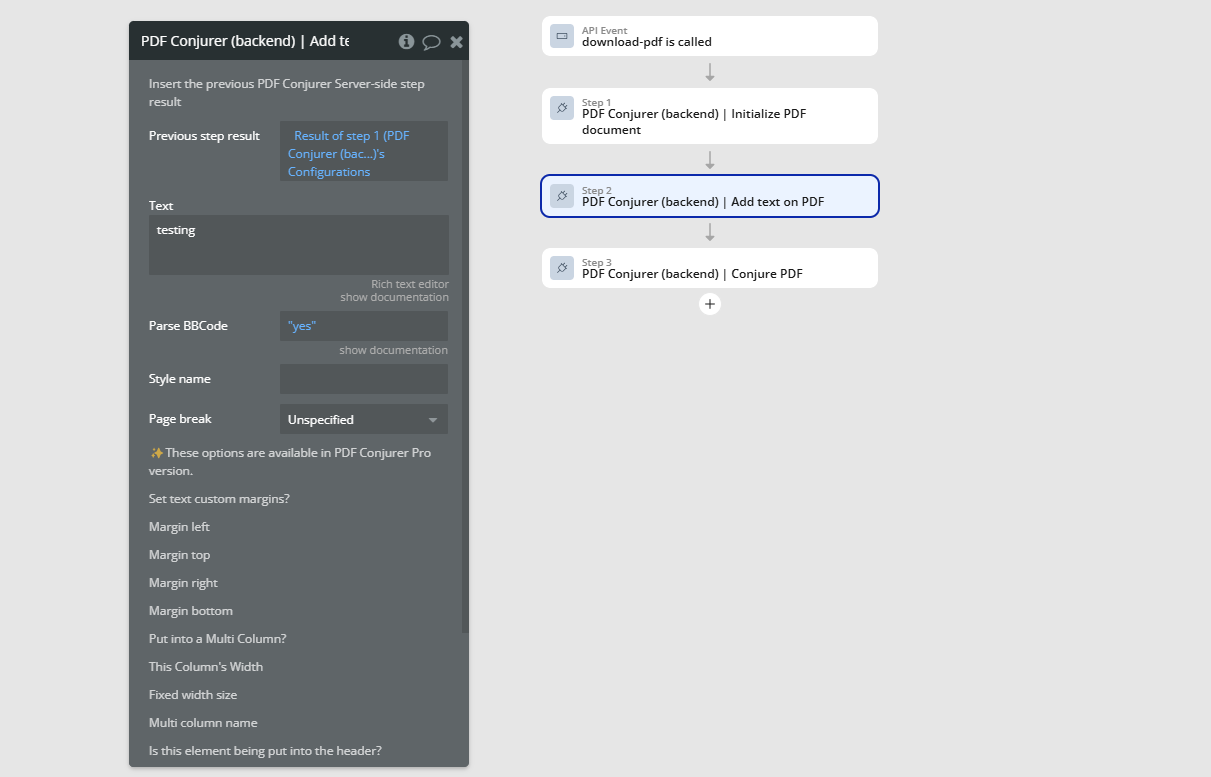

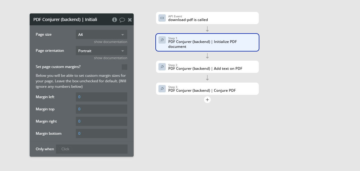

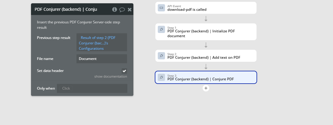

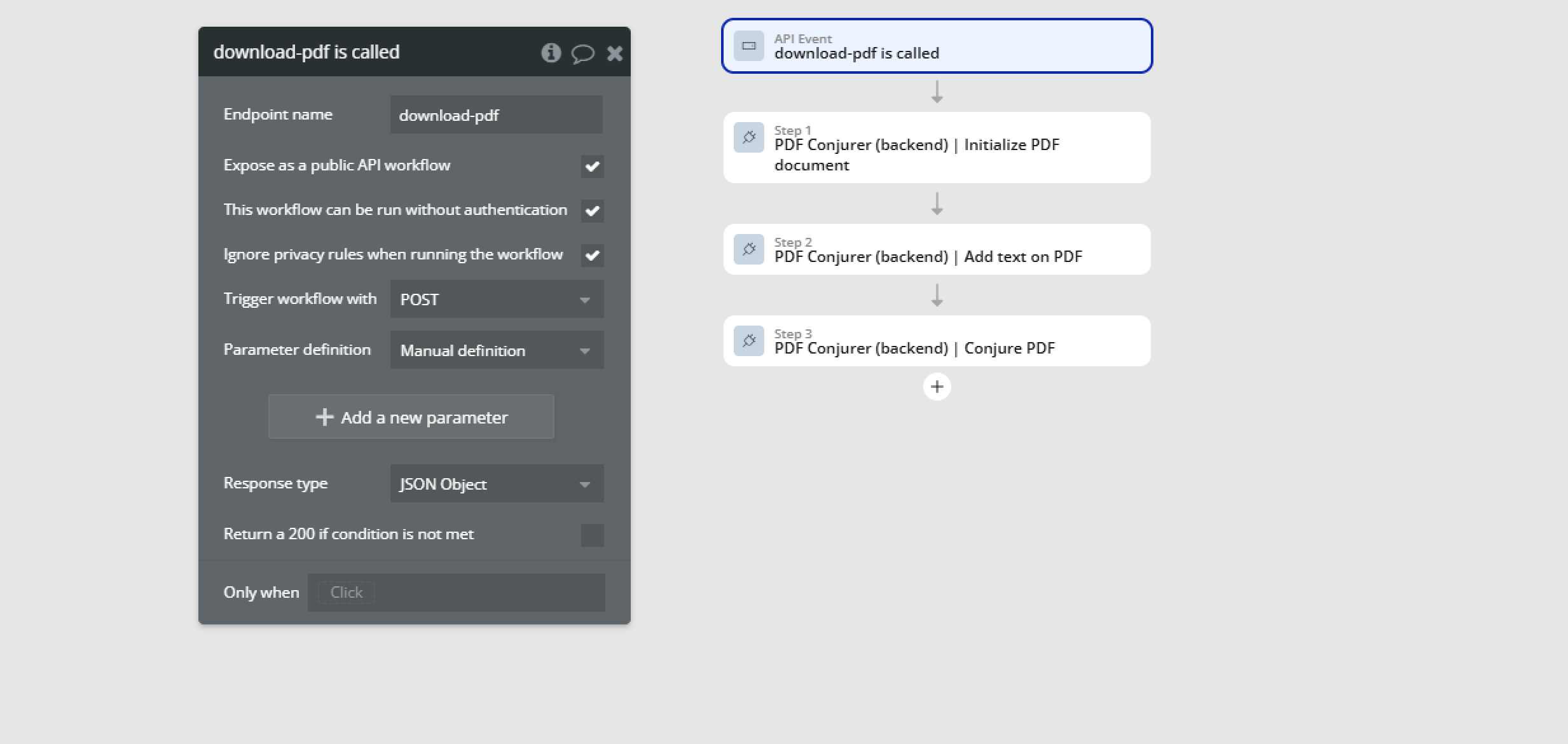

Here is my current setup. This workflow is in the backend. I want to be able to hit a button, and have the pdf download to the computer like in the demo but cannot figure it out.
I went through the documentation but no luck.
What am I doing wrong?

You haven’t added the “create table on PDF” action
without this you aren’t really passing any data for the pdf columns
There are a few things missing. If you are running this on the backend, then it is going to be harder to send it back to the front end to download. Why don’t you want to run it from the front end if you want them to click a button to download it?

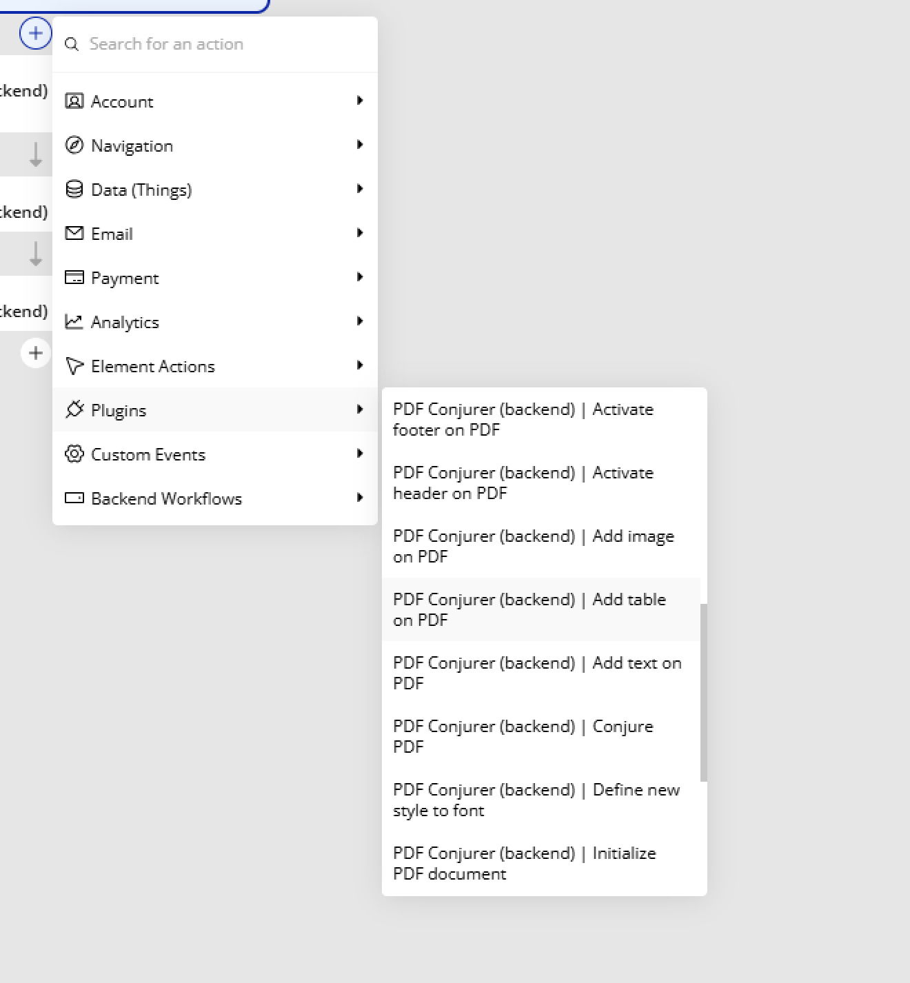

There are different workflows for the front end and the backend. You just have to be consistent on which ones you use. Drop the element on the page to make the front end workflows available.
I have worked a lot with PDF Conjurer in the past before Zeroqode bought them out. It was the best pdf creator out there but just with a really steep learning curve.
oh So I did not know there was an element to add to the page.
I added it however, all the actions are still (backend) actions.
Edit. Nvm it was under element actions and not plugins.
