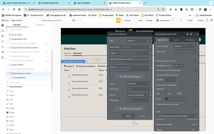

Hi there, I have created this: https://bandejapadelclub.io/
I’m surprised by how slow the page load speed is, especially for the index page (Leaderboard) and for the Evolution page. I’m using tables in those two pages, whereas I’m using repeating groups in the matches page. Could this be the reason? Are repeating groups better for performance? Or do you see something else which could be slowing things down? I’ve tried removing all players pictures but it didn’t seem to improve performance.
Thanks a lot for any pointers!
I haven’t worked with tables but also haven’t come across anything on the forum indicating that they’re slower. What jumps out at me when looking at your tables vs RG is that the search constraints in your tables have additional searches
