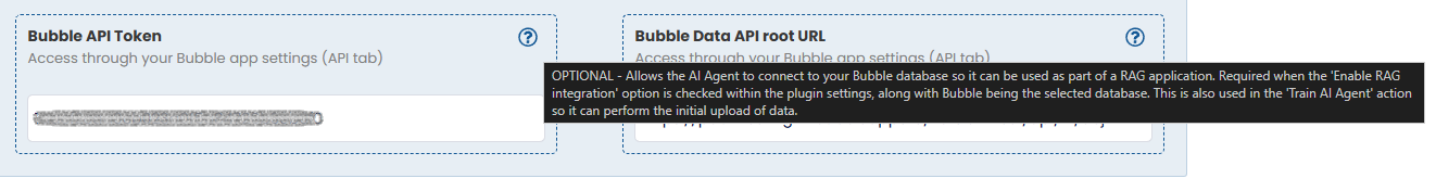

This setup cannot be done on Bubble’s free plan though, because it utilises the Data API and requires an API token to be configured within your app settings.

The action called Train AI Agent is responsible for the initial upload. You can upload single/list text values or single/list of PDF files.
After the upload has been completed, both the Enable RAG integration and External Database Options need to be set.
When the agent requests any data, it does so using the Data API root URL.
This URL and the API token need to be stored in the tokenAuth page. These values are encrypted and decrypted through the plugin (as are all other keys stored).
The plugin now uses the same cosine similarity calculations that are typical for returning embeddings closest to the input it receives.
